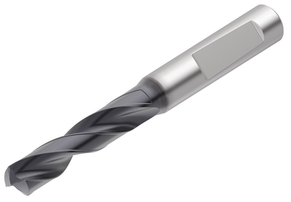

Kenna Universal™ Drill • 3 x D • Whistle Notch™ Shank • Metric
Solid Carbide Drill for Universal Applications
Material Number1913656
ISO Catalog IDB966F04000ANSI Catalog IDB966F04000
- P Steel
- M Stainless Steel
- K Cast Iron
- N Non-Ferrous
- S High-Temp Alloys
Drilling
Drilling: Inclined Exit
Drilling: Stacked Plates
Tool Dimensions: 2flute/4margin/no cool
DIN number 6535
DIN number 6537
Drilling - No Coolant
Flood Coolant: Drilling
Shank - Cylindrical Whistle Notch 2°
Helix Angle: 30°
Drilling: Cross-Hole Drilling
| Material Number | 1913656 |
| ISO Catalog ID | B966F04000 |
| ANSI Catalog ID | B966F04000 |
| Grade | KCU15 |
| [D1] Drill Diameter M | 4 mm |
| [D1] Drill Diameter M | 0.1575 in |
| [L] Overall Length | 66 mm |
| [L] Overall Length | 2.5984 in |
| [L3] Flute Length | 24 mm |
| [L3] Flute Length | 0.9449 in |
| [L4] Maximum Drilling Depth | 17 mm |
| [L4] Maximum Drilling Depth | 0.6693 in |
| [L5] Drill Point Length | 0.66 mm |
| [L5] Drill Point Length | 0.026 in |
| [LS] Shank Length | 36 mm |
| [LS] Shank Length | 1.4173 in |
| [D] Adapter / Shank / Bore Diameter | 6 mm |
| [D] Adapter / Shank / Bore Diameter | 0.2362 in |
- Steel
- Stainless Steel
- Cast Iron
- Non-Ferrous
- High-Temp Alloys
Drilling
DIN number 6535
DIN number 6537
Helix Angle: 30°
- A four-margin land design provides hole straightness and roundness, even when drilling cross holes.
- The low thrust drill point design has excellent centering capabilities, ideal for less stable machining conditions (allowing the drill to work well on a variety of machines).
- Easy to recondition, delivering extended tool life.
- MQL-ready! All shanks fulfil the DIN 6535 and 69090-03 requirements for minimum quantity lubrication.
