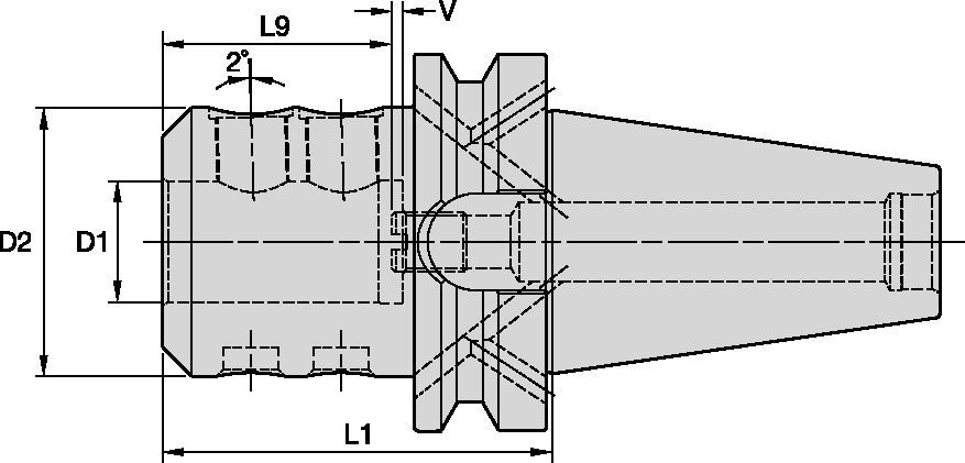

Drawings for 1137558
Material Number1137558
ISO Catalog IDBT50BWN25100M
ANSI Catalog IDBT50BWN25100M
[D1] Adapter / Shank / Bore Diameter25 mm
[D1] Adapter / Shank / Bore Diameter0.984 in
[D2] Body Diameter 1 Workpiece Side 64.5 mm
[D2] Body Diameter 1 Workpiece Side 2.539 in
[L1] Gage Length100 mm
[L1] Gage Length3.937 in
[L9] Clamping Length 50 mm
[L9] Clamping Hole Length 1.9685 in
[V] Adjustment Range 10 mm
[V] Adjustment Range 0.3937 in
Clamp Screw ID Drive Size10 mm
Torque Catalog Newton Meters135
Stop Screw ID Drive Size6 mm
Weight Kilograms4.8
  • Shank - Cylindrical Whistle Notch™Shank - Cylindrical Whistle Notch™
  • Shank - SK BT JIS B 6339Shank - SK BT JIS B 6339
  • Balance - G 6.3@15,000 min-1Balance - G 6.3@15,000 min-1
  • Shank - Cylindrical Whistle Notch™ DIN 1835/EShank - Cylindrical Whistle Notch™ DIN 1835/E
