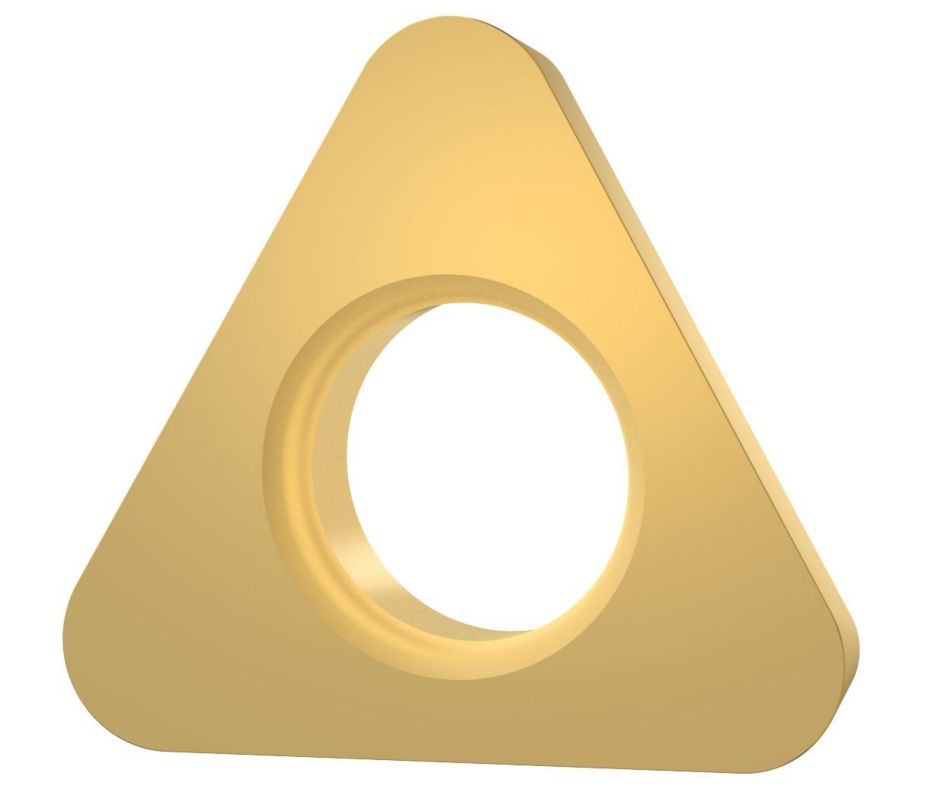

Screw-On Inserts
Material Number1937535
ISO Catalog IDTDHB07T1202ANSI Catalog IDTDHB12807505
Screw-On TDHB ISO/ANSI Turning Insert 1937535 - Kennametal
$23.73/each
Drawings for 1937535
GradeKC5010
[D] Insert IC Size4.075 mm
[D] Insert IC Size0.16 in
[L10] Insert Cutting Edge Length7.04 mm
[L10] Insert Cutting Edge Length0.277 in
[S] Insert Thickness1.191 mm
[S] Insert Thickness0.0469 in
[Rε] Corner Radius 0.175 mm
[Rε] Corner Radius 0.007 in
[D1] Insert Hole Size 2.41 mm
[D1] Insert Hole Size 0.095 in
KC5010
KC5010
Composition: An advanced PVD AlTiN coating over a very deformation-resistant unalloyed carbide substrate. The new and improved coating enables speeds to be increased by 50–100%.
Application: The KC5010 grade is ideal for finishing to general machining of most workpiece materials at higher speeds. Excellent for machining most steels, stainless steels, cast irons, non-ferrous materials, and super alloys under stable conditions. It also performs well machining hardened and short chipping materials.
