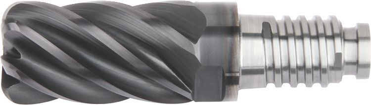

DUO-LOCK™ • HARVI™ III • Radiused • 6 Flutes • Inch
HARVI III • UJDV • Unequal Flute Spacing • Eccentric Relief
Material Number6072243
ISO Catalog IDUJDV0625Y6CQDANSI Catalog IDUJDV0625Y6CQD

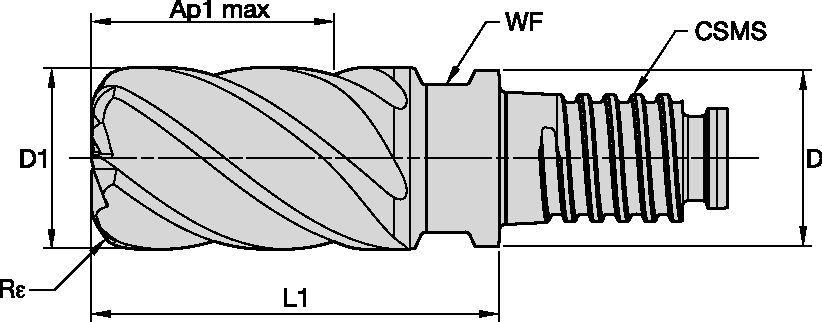

  • Tool Dimensions: Flute Configuration: 6Tool Dimensions: Flute Configuration: 6
Drawings for 6072243
GradeKCSM15
Adapter Style Machine SideDUO-LOCK
[D] Adapter / Shank / Bore Diameter15.375 mm
[D] Adapter / Shank / Bore Diameter0.6053 in
[AP1MAX] 1st Maximum Cutting Depth23.812 mm
[AP1MAX] 1st Maximum Cutting Depth0.9375 in
[L1] Gage Length35.7 mm
[L1] Gage Length1.406 in
[CSMS] System Size Machine SideDL16
[WF] Width of Flat 13 mm
[WF] Width of Flat 0.5118 in
[Re] Corner Radius 2.275 mm
[Re] Corner Radius 0.09 in
[Z] Number of Flutes6
[D1] Effective Cutting Diameter15.875 mm
[D1] Effective Cutting Diameter0.625 in

KCSM15
KCSM15
Coated carbide grade with thick PVD coating and optimized chemistry
and process for increased wear resistance. Outstanding protection in milling stainless steel to mitigate crater, DOCN (depth-of-cut notching), and flank wear. Excellent performance up to 52 HRC.
  • Unequal flute spacing and variable helix configuration minimize chatter and harmonics for smoother machining.
  • Center cutting.
  • Optimized geometry for titanium machining.
  • Single tool for both roughing and finishing, reducing setups.
