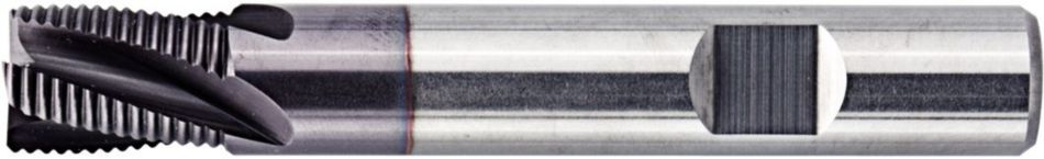

KenCut™ RR • MDRHEC • Chamfered • 4-5 Flutes • Weldon® Shank • Inch
Solid Carbide End Mill for Roughing of Steels, Stainless Steel, Cast Iron
Material Number4048692
ISO Catalog IDMDRHEC375S4038ANSI Catalog IDMDRHEC375S4038
KenCut™ RR - MDRHEC - Chamfered - 4-5 Flutes - Weldon® Shank - Inch 4048692 - Kennametal
$106.05/each
  • Tool Dimensions: Flute Configuration: 4Tool Dimensions: Flute Configuration: 4
  • Helix Angle: 20°Helix Angle: 20°
Drawings for 4048692
GradeKCPM15
Adapter Style Machine SideWeldon
[D1] Effective Cutting Diameter9.525 mm
[D1] Effective Cutting Diameter0.375 in
[D] Adapter / Shank / Bore Diameter9.525 mm
[D] Adapter / Shank / Bore Diameter0.375 in
[AP1MAX] 1st Maximum Cutting Depth12.7 mm
[AP1MAX] 1st Maximum Cutting Depth0.5 in
[L3] Usable Length12.7 mm
[L3] Usable Length0.5 in
[L] Overall Length 50.8 mm
[L] Overall Length 2 in
[BCH] Corner Chamfer Width 0.5 mm
[BCH] Corner Chamfer Width 0.0197 in
[Z] Number of Flutes4
KCPM15
KCPM15
  • Solid carbide end mill with cord profile, for low cutting forces and low power consumption
