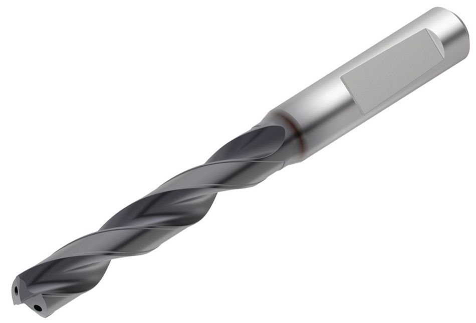

Kenna Universal™ Drill • 5 x D • Internal Coolant • Whistle Notch™ Shank • Metric
Solid Carbide Drill for Universal Applications

  • DrillingDrilling
  • Tool Dimensions: 2flute/4margin/coolantTool Dimensions: 2flute/4margin/coolant
  • DIN number 6535DIN number 6535
  • DIN number 6537DIN number 6537
  • Through Coolant: MQL (Minimum Quantity Lubricant): DrillingThrough Coolant: MQL (Minimum Quantity Lubricant): Drilling
  • Shank - Cylindrical Whistle Notch 2°Shank - Cylindrical Whistle Notch 2°

GradeKCU15
[D1] Drill Diameter M 18 mm
[D1] Drill Diameter M 0.7087 in
[L] Overall Length 143 mm
[L] Overall Length 5.6299 in
[L3] Flute Length 93 mm
[L3] Flute Length 3.6614 in
[L4] Maximum Drilling Depth 71 mm
[L4] Maximum Drilling Depth 2.7953 in
[L5] Drill Point Length3.12 mm
[L5] Drill Point Length0.1228 in
[LS] Shank Length 48 mm
[LS] Shank Length 1.8898 in
[D] Adapter / Shank / Bore Diameter18 mm
[D] Adapter / Shank / Bore Diameter0.7087 in
  • DrillingDrilling
  • A four-margin land design provides hole straightness and roundness, even when drilling cross holes.
  • The low thrust drill point design has excellent centering capabilities, ideal for less stable machining conditions (allowing the drill to work well on a variety of machines).
  • Easy to recondition, delivering extended tool life.
  • MQL-ready! All shanks fulfil the DIN 6535 and 69090-03 requirements for minimum quantity lubrication.
