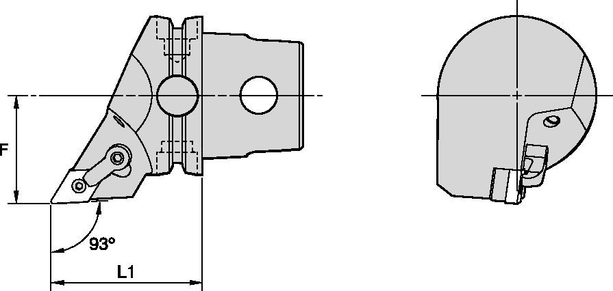

MDJN 93°
M-Clamping
Material Number3901290
ISO Catalog IDKM40TSMDJNL1506ANSI Catalog IDKM40TSMDJNL1506
[L1] Tool Length 40 mm
[L1] Tool Length 1.5748 in
[F] F Dimension 27 mm
[F] F Dimension 1.063 in
Gage InsertDN..150608/DN..442
Weight Kilograms0.26
Weight Pounds0.57
