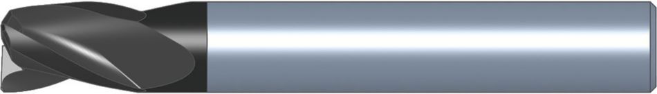

GOmill™ GP • Chamfered • 3 Flutes • DIN 6527 Plain Shank • Short/Long • Metric
General Purpose Solid Carbide End Mill
Material Number6146886
ISO Catalog ID3CH1800DK018AANSI Catalog ID3CH1800DK018A
GradeKC633M
[D1] Effective Cutting Diameter18 mm
[D1] Effective Cutting Diameter0.7087 in
[D] Adapter / Shank / Bore Diameter18 mm
[D] Adapter / Shank / Bore Diameter0.7087 in
[AP1MAX] 1st Maximum Cutting Depth18 mm
[AP1MAX] 1st Maximum Cutting Depth0.7087 in
[L] Overall Length 84 mm
[L] Overall Length 3.3071 in
[BCH] Corner Chamfer Width 0.3 mm
[BCH] Corner Chamfer Width 0.0118 in
[Z] Number of Flutes3

Coated carbide grade with PVD multilayer coating. KC633M™ is designed for dry milling most types of material, apart from the hardened variety. This grade is characterized by high hardness and wear resistance. It provides outstanding protection for solid carbide tools against cratering and abrasion.
  • Solid carbide end mill with stepped parallel shank according to DIN 6527
  • Solid carbide end mill with excellent cost-benefit ratio
  • Eccentric relief increases cutting edge stability for long tool life and high surface quality
  • Eccentric relief eases regrinding and reduces reconditioning cost
