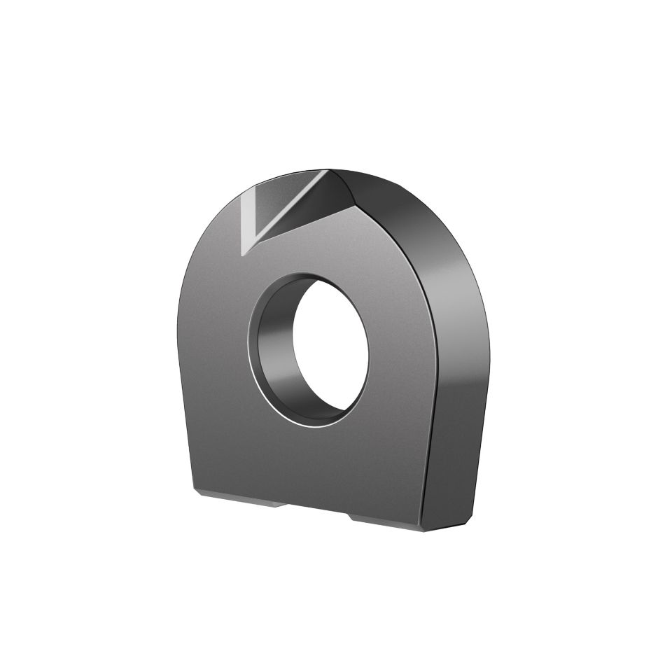

KDMB™ • Carbide Insert • KDMB-GN • Light Machining • Metric
Indexable Inserts
Material Number6784102
ISO Catalog IDKDMB12M0ERGNANSI Catalog IDKDMB12M0ERGN
- P Steel
- M Stainless Steel
- K Cast Iron
- S High-Temp Alloys
- H Hardened Materials
| Material Number | 6784102 |
| ISO Catalog ID | KDMB12M0ERGN |
| ANSI Catalog ID | KDMB12M0ERGN |
| Grade | KCU15 |
| [W] Cutting Width | 12 mm |
| [W] Cutting Width | 0.4724 in |
| [S] Insert Thickness | 2.5 mm |
| [S] Insert Thickness | 0.0984 in |
| [RC] Corner Radius Center | 6 mm |
| [RC] Corner Radius Center | 0.236 in |
- Steel
- Stainless Steel
- Cast Iron
- High-Temp Alloys
- Hardened Materials
- High-precision insert.
