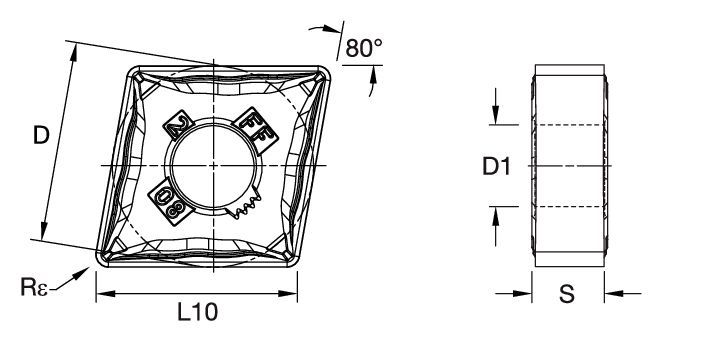

Drawings for 1624156
Material Number1624156
ISO Catalog IDCNMG090304FF
ANSI Catalog IDCNMG321FF
GradeKC5010
[D] Insert IC Size9.525 mm
[D] Insert IC Size0.375 in
[L10] Insert Cutting Edge Length9.672 mm
[L10] Insert Cutting Edge Length0.3808 in
[S] Insert Thickness3.18 mm
[S] Insert Thickness0.125 in
[Rε] Corner Radius 0.4 mm
[Rε] Corner Radius 0.016 in
[D1] Insert Hole Size 3.81 mm
[D1] Insert Hole Size 0.15 in

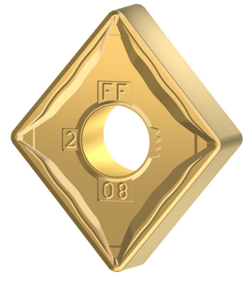

KC5010
KC5010
Composition: An advanced PVD AlTiN coating over a very deformation-resistant unalloyed carbide substrate. The new and improved coating enables speeds to be increased by 50–100%.
Application: The KC5010 grade is ideal for finishing to general machining of most workpiece materials at higher speeds. Excellent for machining most steels, stainless steels, cast irons, non-ferrous materials, and super alloys under stable conditions. It also performs well machining hardened and short chipping materials.
  • Finishing geometry for high-surface finish demands.
