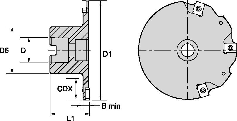

  • Slotting: Side with AE/AP dimensionsSlotting: Side with AE/AP dimensions
Drawings for 1067766
Material Number1067766
ISO Catalog IDKS255BLNE1245
ANSI Catalog IDKS255BLNE1245
[D1] Effective Cutting Diameter63.5 mm
[D1] Effective Cutting Diameter2.5 in
[D] Adapter / Shank / Bore Diameter19.07 mm
[D] Adapter / Shank / Bore Diameter0.75 in
[D6] Hub Diameter 40.132 mm
[D6] Hub Diameter 1.58 in
[BM] Cutting Width Minimum7.925 mm
[BM] Cutting Width Minimum0.312 in
[CDX] Radial Maximum Depth of Cut14.224 mm
[CDX] Radial Maximum Depth of Cut0.56 in
[L1] Gage Length47.625 mm
[L1] Gage Length1.875 in
Number of Inserts6
[Z] Number of Flutes3
Gage InsertLNE_1245___
Max RPM9400

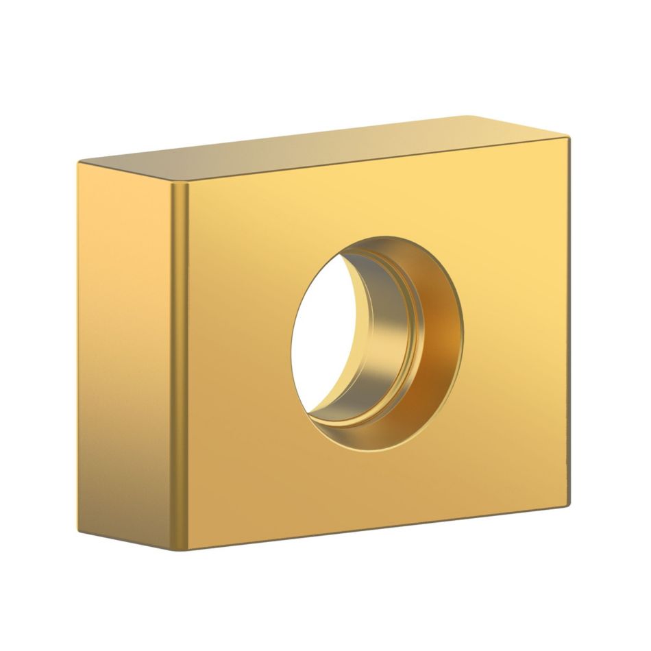

Narrow Slotting LN Series • Carbide Insert• LNEU-R • Light Machining
Narrow Slotting LN Series • Carbide Insert• LNEQ-R • Heavy Machining
