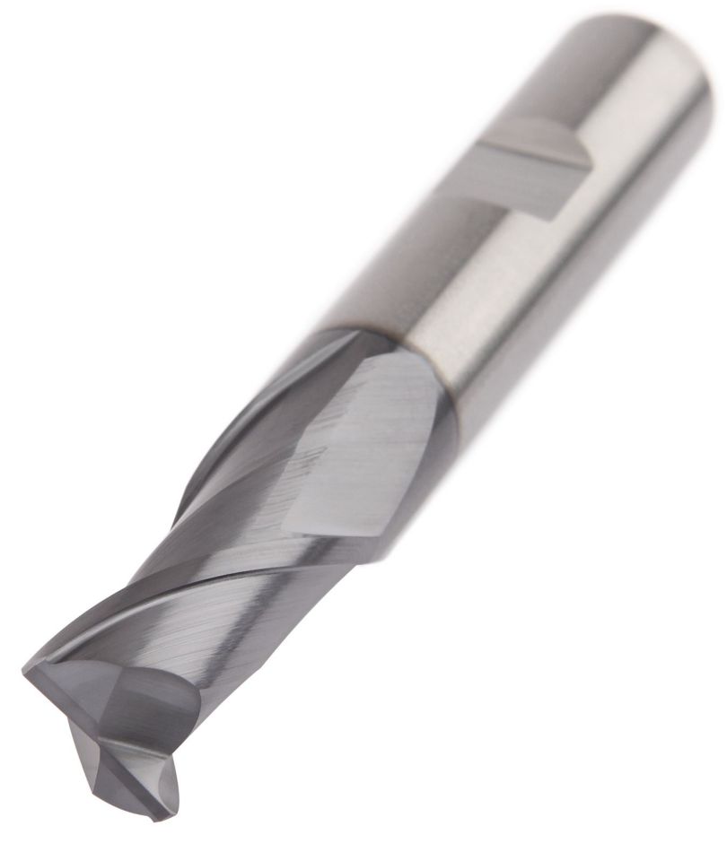

General Purpose Solid Carbide End Mill
- Solid carbide end mill with stepped parallel shank according to DIN 6527.
- Solid carbide end mill with excellent cost-benefit ratio.
- Eccentric relief increases cutting edge stability for long tool life and high surface quality.
- Eccentric relief eases regrinding and reduces reconditioning cost.
- Center cutting for plunging and ramping operations.
Plunge Milling
Ramping: Blank
Slotting: Square End

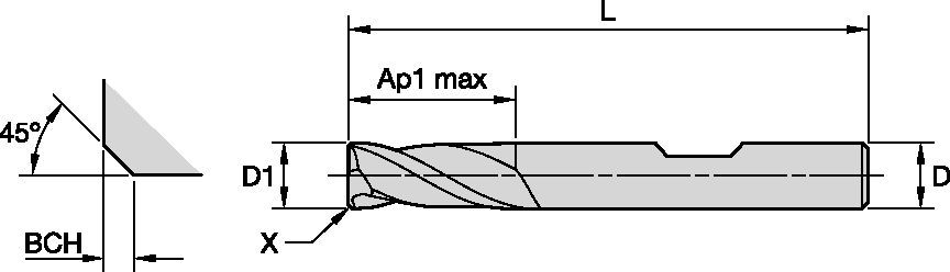

DIN number 6527
Tool Dimensions: Flute Configuration: 2
Helix Angle: 30°
Corner Style: Corner Chamfer
End Mill Tolerances | |||
D1 | tolerance e8 | D | tolerance h6 + / - |
≤ 3 | -0,014 / -0,028 | ≤ 3 | +0 / -0,006 |
-0,020 / -0,038 | +0 / -0,008 | ||
-0,025 / -0,047 | +0 / -0,009 | ||
-0,032 / -0,059 | +0 / -0,011 | ||
-0,040 / -0,073 | +0 / -0,013 |
