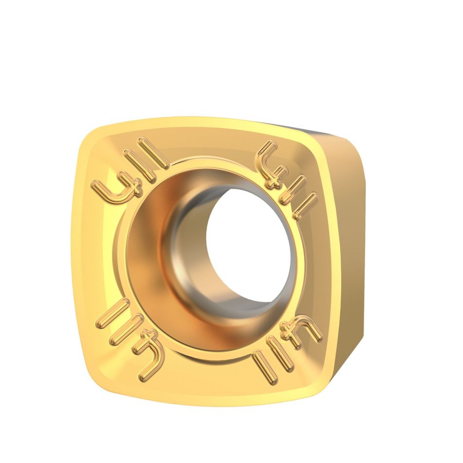

7792VXD09 Series • Carbide Insert • XDLT-D411 • Light Machining
High-feed copy milling insert with four cutting edges, precision ground.
Material Number5655172
ISO Catalog IDXDLT090412ERD411ANSI Catalog IDXDLT090412ERD411
7792VX09 IN XDLT-411 Milling - 5655172 - Kennametal
$34.50/each
Drawings for 5655172
GradeX500
[D] Insert IC Size9.525 mm
[D] Insert IC Size0.375 in
[LI] Insert Length 9.525 mm
[LI] Insert Length 0.375 in
[S] Insert Thickness4.75 mm
[S] Insert Thickness0.187 in
[Rε] Corner Radius 1.2 mm
[Rε] Corner Radius 0.047 in
Average Chip Thickness [HM]0.05 mm
Average Chip Thickness [HM]0.002 in
[RT] Theoretical Corner Radius Programing2.27 mm
[RT] Theoretical Corner Radius Programing0.089 in
X500
X500
CVD TiN/TiCN/TiN coated carbide on tough substrate (X-Grade™ technology). For difficult applications with heavy impacts, vibrations, or unstable conditions. High stability against thermal cracks. Excellent grade for high-temperature alloys, stainless steels, and titanium.
  • Precision ground insert for best surface finish
  • Single-sided copy milling insert for machining of steels, stainless steel and high-temperature alloys
