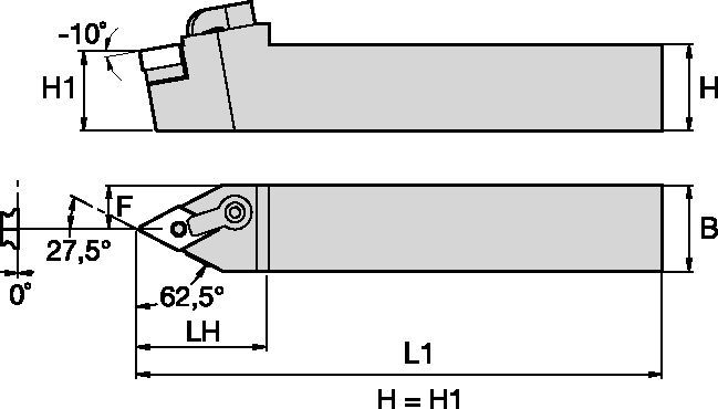

Drawings for 1096277
Material Number1096277
ISO Catalog IDMDPNN123B
ANSI Catalog IDMDPNN123B
[H] Shank Height 19.05 mm
[H] Shank Height 0.75 in
[B] Shank Width 19.05 mm
[B] Shank Width 0.75 in
[F] F Dimension 9.525 mm
[F] F Dimension 0.375 in
[L1] Tool Length 114.3 mm
[L1] Tool Length 4.5 in
[LH] Head Length 38.1 mm
[LH] Head Length 1.5 in
Gage InsertDN..332
Lock Pin ID Drive Size5/64
Clamp Screw ID Drive Size3/32
