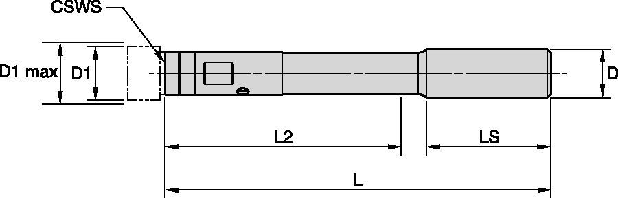

Drawings for 3861190
Material Number3861190
ISO Catalog IDSS20KST175AR5M
ANSI Catalog IDSS20KST175AR5M
[CSWS] System Size Workpiece SideKST175
[D1] Adapter / Shank / Bore Diameter20 mm
[D1] Adapter / Shank / Bore Diameter0.787 in
[D1MAX] Maximum Adaptor/Bore Diameter22.499 mm
[D1MAX] Maximum Adaptor/Bore Diameter0.8858 in
[D] Adapter / Shank / Bore Diameter20 mm
[D] Adapter / Shank / Bore Diameter0.7874 in
[L] Overall Length 158.5 mm
[L] Overall Length 6.2402 in
[L2] Usable Length 96.5 mm
[L2] Usable Length 3.799 in
[LS] Shank Length 51 mm
[LS] Shank Length 2.0079 in
  • Tool body shipped with lock screw and wrench.
  • Order reamer head separately.
