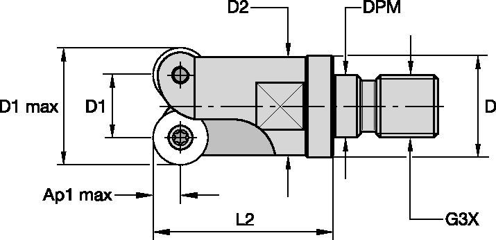

Número de material | 1888414 |
ID do catálogo ISO | 35E06R043M16SRD07 |
ID do catálogo ANSI | 35E06R043M16SRD07 |
[D1MAX] Maximum Cutting Diameter | 35 mm |
[D1MAX] Maximum Cutting Diameter | 1.378 in |
[D1] Effective Cutting Diameter | 28 mm |
[D1] Effective Cutting Diameter | 1.1024 in |
[D] Adapter / Shank / Bore Diameter | 29 mm |
[D] Adapter / Shank / Bore Diameter | 1.1417 in |
[D2] Maximum Body Diameter | 32 mm |
[D2] Maximum Body Diameter | 1.2598 in |
[DPM] Pilot Diameter Machine Side | 17 mm |
[DPM] Pilot Diameter Machine Side | 0.6693 in |
[G3X] Connection Thread Size External | M16 |
[L2] Head Length | 43 mm |
[L2] Head Length | 1.6929 in |
[AP1MAX] 1st Maximum Cutting Depth | 3.5 mm |
[AP1MAX] 1st Maximum Cutting Depth | 0.1378 in |
Number of Inserts | 6 |
Maximum Ramping Angle | 4.5 |
Weight Pounds | 0.55 |
Gage Insert | RD__0702__ |
