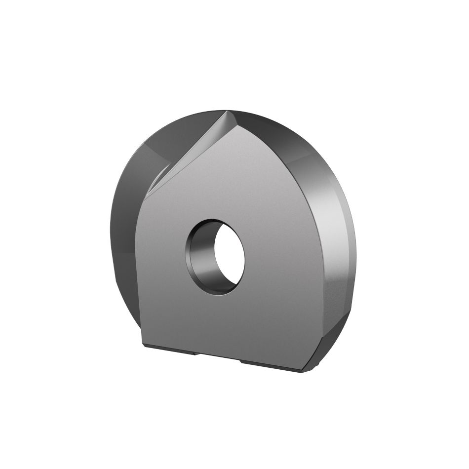

KDMB™ • Carbide Insert • KDMB-GP • Medium Machining • Inch
Ball nose copy milling insert, precision ground
Material Number6784083
ISO Catalog IDKDMB0750M0ERGPANSI Catalog IDKDMB0750M0ERGP
- P Steel
- M Stainless Steel
- K Cast Iron
- H Hardened Materials
| Material Number | 6784083 |
| ISO Catalog ID | KDMB0750M0ERGP |
| ANSI Catalog ID | KDMB0750M0ERGP |
| Grade | KCPK10 |
| [W] Cutting Width | 19.05 mm |
| [W] Cutting Width | 0.75 in |
| [S] Insert Thickness | 3 mm |
| [S] Insert Thickness | 0.1181 in |
| [RC] Corner Radius Center | 9.525 mm |
| [RC] Corner Radius Center | 0.375 in |
| Average Chip Thickness [HM] | 0.05 mm |
| Average Chip Thickness [HM] | 0.002 in |
- Steel
- Stainless Steel
- Cast Iron
- Hardened Materials
KCPK10
Composition: Advanced CVD TiCN-Al2O3 coating combined with a cobalt-enriched carbide substrate.
Application: The KCPK10 grade offers a balanced combination of deformation resistance and edge toughness leading to outstanding abrasion and crater wear resistance for high-speed machining of steel and cast iron. Use for very high cutting speeds with low to medium feed rates.
- Precision ground insert for best surface finish.
- With helical geometry for lower cutting forces.
KDMB Ball Nose • .250"
