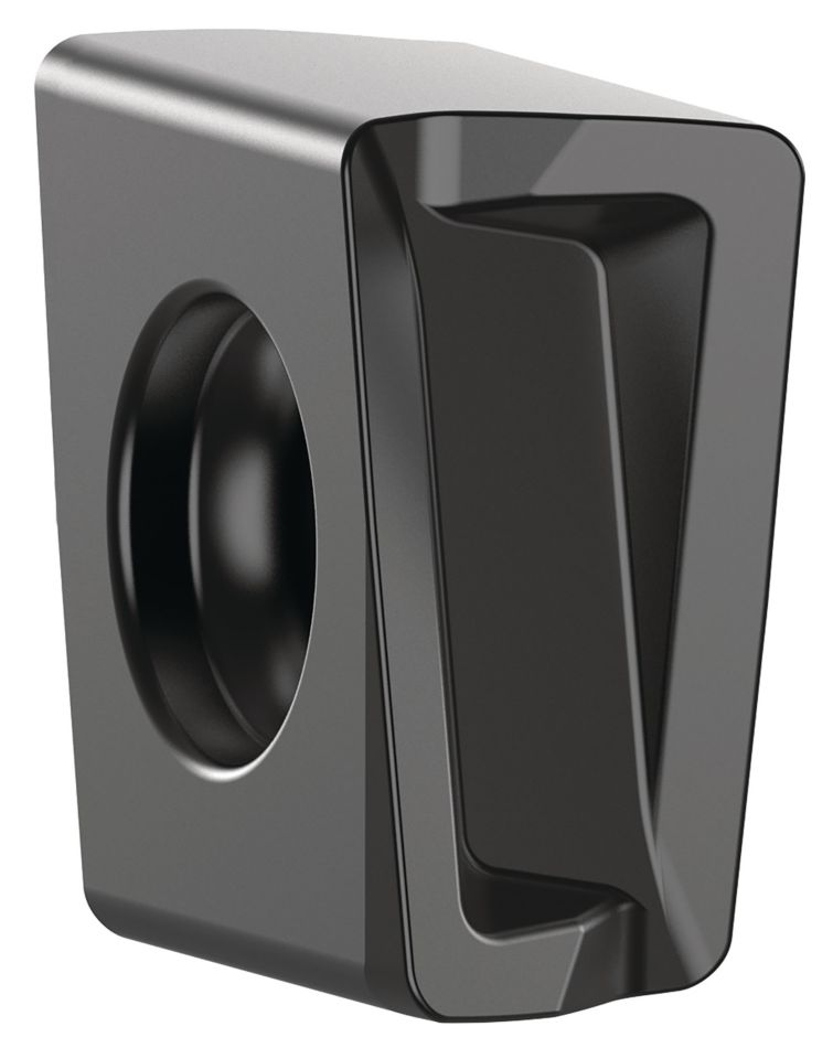

Mill 4-12KT™ • KSSM™ 12 • Carbide Insert • LNGQ-L-GE • Left Handed Inserts for Made-To-Order Slotting Cutters
Shoulder milling insert with four cutting edges per insert, precision ground
Material Number6723764
ISO Catalog IDLNGQ120631ELGEKT4ANSI Catalog IDLNGQ120631ELGEKT4
M412KT IN LH LNGQ-EL-GE Milling - 6723764 - Kennametal

    Drawings for 6723764
    GradeKCPK30
    [LI] Insert Length 13 mm
    [LI] Insert Length 0.5118 in
    [S] Insert Thickness6.35 mm
    [S] Insert Thickness0.25 in
    [W] Insert Width 12.628 mm
    [W] Insert Width 0.4972 in
    [Rε] Corner Radius 3.175 mm
    [Rε] Corner Radius 0.125 in
    Average Chip Thickness [HM]0.05 mm
    Average Chip Thickness [HM]0.002 in
    Cutting Edges per Insert4
    KCPK30
    KCPK30
    Coated carbide grade with CVD multilayer (TiN/TiCN/Al2O3) and advanced Beyond™ post-coat treatment. Substrate is very tough. KCPK30 has a wide application area in general and roughing milling of steels and cast irons. Performs best dry, but can also be used wet.
    • Precision ground insert for best surface finish.
    • Advanced insert/pocket interface ensures stability and consistent performance in difficult applications.
    • Up to 15% lower power consumption.
    • Easy insert indexing through screw clamping.
