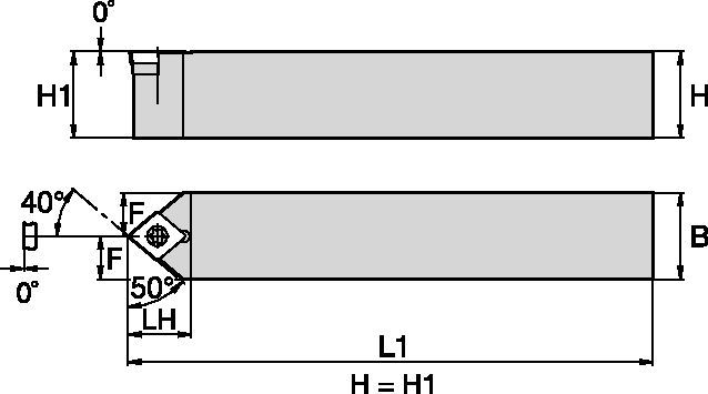

Drawings for 1094502
Material Number1094502
ISO Catalog IDSCMCN123
ANSI Catalog IDSCMCN123
[H] Shank Height 19.05 mm
[H] Shank Height 0.75 in
[B] Shank Width 19.05 mm
[B] Shank Width 0.75 in
[F] F Dimension 9.525 mm
[F] F Dimension 0.375 in
[L1] Tool Length 114.3 mm
[L1] Tool Length 4.5 in
[LH] Head Length 15.7 mm
[LH] Head Length 0.62 in
Gage InsertCC..3252
Shim Screw ID Drive Size3.5 mm
Insert Screw ID Drive SizeT15
