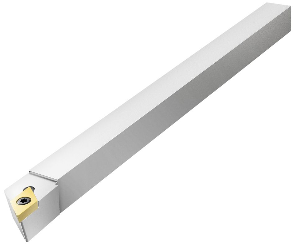

Drawings for 1097854
Material Number1097854
ISO Catalog IDSDJCR2525M11
ANSI Catalog IDSDJCR2525M11
[H] Shank Height 25 mm
[H] Shank Height 0.9843 in
[B] Shank Width 25 mm
[B] Shank Width 0.9843 in
[F] F Dimension 32 mm
[F] F Dimension 1.2598 in
[L1] Tool Length 150 mm
[L1] Tool Length 5.906 in
[LH] Head Length 22 mm
[LH] Head Length 0.87 in
Gage InsertDC..11T308
Shim Screw ID Drive Size3.5 mm
Insert Screw ID Drive SizeT15
  • TurningTurning
  • ProfilingProfiling
