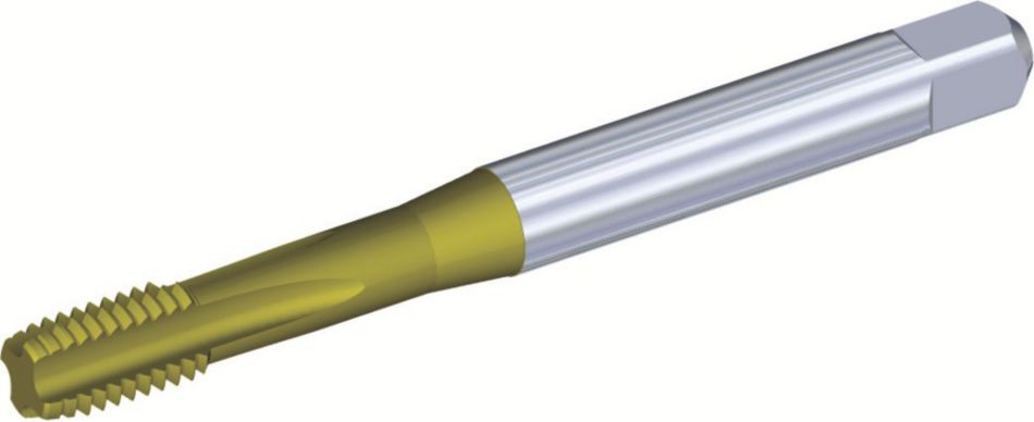

T640 • DIN 371 and 376 • Form C Semi-Bottoming Chamfer • Machine Screw and Fractional
Beyond™ Straight-Flute HSS-E-PM Taps • Through and Blind Holes
Material Number5212248
ISO Catalog IDT640NC06-32R2BX-D1ANSI Catalog IDT640NC06-32R2BX-D1
T640 STFL DIN Inch Threading - 5212248 - Kennametal

Drawings for 5212248
GradeKP6525
[D1-TDZ] Thread Diameter Size#6 - 32
[L] Overall Length 56 mm
[L] Overall Length 2.205 in
[L3] Thread Length 9 mm
[L3] Thread Length 0.354 in
[L2] Useable Length 20 mm
[L2] Useable Length 0.787 in
[D] Adapter / Shank / Bore Diameter4 mm
[D] Adapter / Shank / Bore Diameter0.1575 in
[Z] Number of Flutes3
Dimension StandardDIN 371
Thread Tolerance Class ANSI2BX
  • Tapping: Through HoleTapping: Through Hole
  • Threading: Blind HoleThreading: Blind Hole
  • DIN number 371DIN number 371
  • DIN number 376DIN number 376
  • Chamfer Form C (2–3)Chamfer Form C (2–3)
  • HSS-E-PMHSS-E-PM
  • Class of Fit: 2BXClass of Fit: 2BX
  • Class of Fit: 3BXClass of Fit: 3BX
  • Manufacturer’s Specs: UNFManufacturer’s Specs: UNF
  • Manufacturer’s Specs: UNCManufacturer’s Specs: UNC
  • Tapping Helix Angle: 0°Tapping Helix Angle: 0°
KP6525
KP6525
Coated HSS-E-PM. PVD — heat- and wear-resistant high vanadium — cobalt powder metal HSS substrate coated with wear-resistant TiCN base layer and low-friction TiN top layer. Use in steel, cast iron, and cast aluminum with silicon.
  • KP6525 TiCN + TiN for cast iron and cast aluminum.
