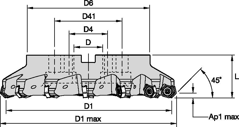

Dodeka MAX™ 45° • Shell Mill • Metric
Face milling cutter • Heavy duty machining of multiple materials
Material Number100000539
- Internal coolant supply.
Face Milling
Side Milling/Shoulder Milling: Eased Chamfer
Milling - Through Coolant
Milling - Side and Face
