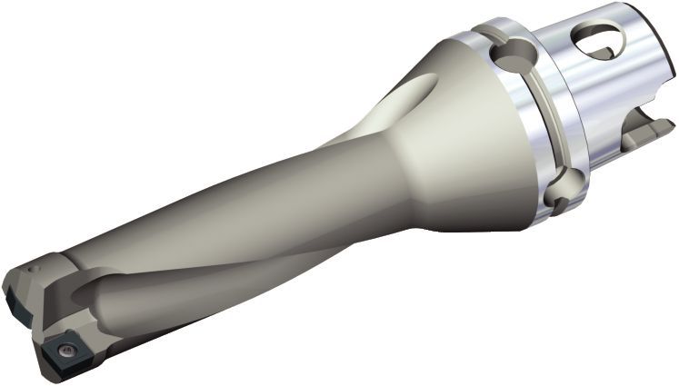

DFS KM40TS Shank • KM50TS Shank • 3 x D • Right Hand • Metric
Drill Fix™ DFSP™ Bodies
Material Number4122502
ISO Catalog IDKM40TSDFS290R3MANSI Catalog IDKM40TSDFS290R3M
DFS KM40/50/63_TS/XMZ 3xD mm Holemaking - 4122502 - Kennametal
$609.60/each
  • DrillingDrilling
  • Drilling: Inclined EntryDrilling: Inclined Entry
  • Drilling: X-OffsetDrilling: X-Offset
  • Drilling: ConvexDrilling: Convex
  • Through Coolant: Radial: Indexable DrillingThrough Coolant: Radial: Indexable Drilling
  • Drilling: BlindDrilling: Blind
  • Chain DrillingChain Drilling
  • Drilling: Half-Cylindrical DrillingDrilling: Half-Cylindrical Drilling
  • Drilling: Corner Drilling 45°Drilling: Corner Drilling 45°
Drawings for 4122502
[CSMS] System Size Machine SideKM40TS
[D1] Drill Diameter M 29 mm
[D1] Drill Diameter M 1.1417 in
[D1MAX] Drill Diameter Maximum30 mm
[D1MAX] Drill Diameter Maximum1.1811 in
[L1] Insert Gage Length 133 mm
[L1] Insert Gage Length 5.2362 in
[L4] Maximum Drilling Depth 87 mm
[L4] Maximum Drilling Depth 3.4252 in
[L5] Drill Point Length0.768 mm
[L5] Drill Point Length0.0302 in
Gage InsertSPPX09T3.
Gage Insert 2DFT05T3.
  • DrillingDrilling
  • DFSP combines the economical squared outboard insert with the superior centering capabilities of the trigon inboard insert.
  • Benefit from the KM-TS™ coupling as it is the most precise and stable tooling system allowing fully automated tool changing.
  • Drill shipped with insert screws and Torx wrench.
