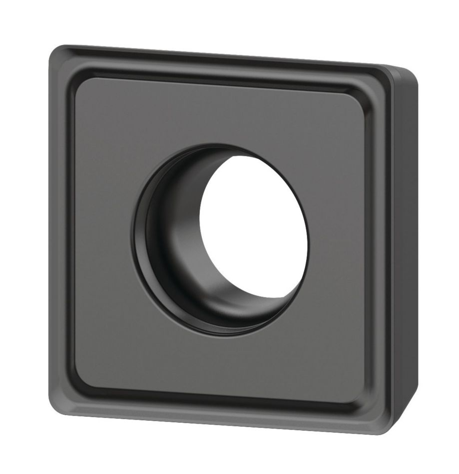

Material Number7034358
ISO Catalog IDDFPR140408PKO
ANSI Catalog IDDFPR140408PKO
GradeKCU40
[D1] Insert Hole Size 5.55 mm
[D1] Insert Hole Size 0.219 in
[D] Insert IC Size13.55 mm
[D] Insert IC Size0.533 in
[Rε] Corner Radius 0.8 mm
[Rε] Corner Radius 0.031 in
[S] Insert Thickness4.4 mm
[S] Insert Thickness0.173 in

KCU40
KCU40
Multilayered PVD TiN-TiAlN-coated fine-grain carbide, offering
highest wear resistance in steel, stainless steel, cast iron, and high-temp alloys.
  • Four true cutting edges for lowest cost per part.
  • Outboard Insert with wiper-facets for superiour surface finish.
