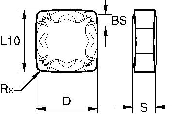

Drawings for 2957725
Material Number2957725
ISO Catalog IDSNXF120412SNHE
ANSI Catalog IDSNXF433SNHE
GradeKC527M
[D] Insert IC Size12.7 mm
[D] Insert IC Size.5 in
[S] Insert Thickness4.76 mm
[S] Insert Thickness.1874 in
[L10] Insert Cutting Edge Length.5 in
[Rε] Corner Radius 1.2 mm
[Rε] Corner Radius .0468 in
Average Chip Thickness [HM]0.055 mm
Average Chip Thickness [HM].0022 in
Cutting Edges per Insert8
