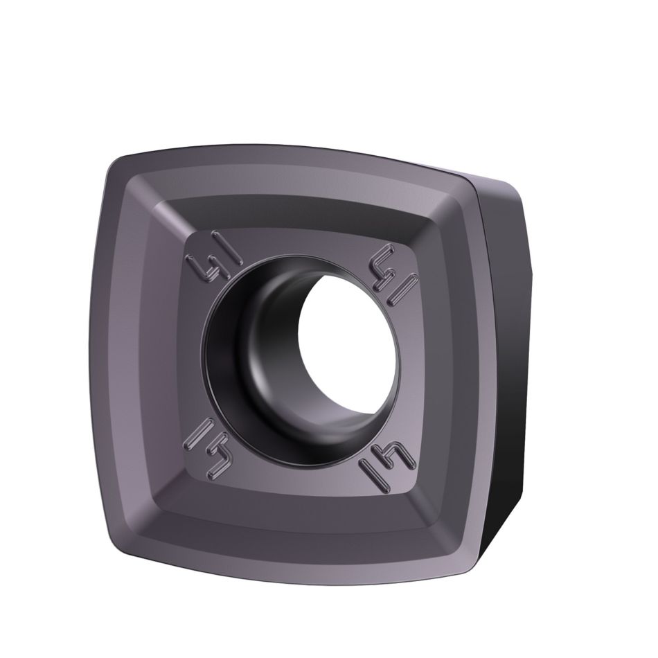

7792VXD12 Series • Carbide Insert • XDLT-D41 • Medium Machining
High-feed copy milling insert with four cutting edges, precision ground.
Material Number5654220
ISO Catalog IDXDLT120508ERD41ANSI Catalog IDXDLT120508ERD41
XDLT12-D41 - General purpose in soft steels. Best fit for face milling, slotting operation 5654220 - Kennametal
GradeSP6519
[D] Insert IC Size12.7 mm
[D] Insert IC Size0.5 in
[LI] Insert Length 12.7 mm
[LI] Insert Length 0.5 in
[S] Insert Thickness5.56 mm
[S] Insert Thickness0.219 in
[Rε] Corner Radius 0.8 mm
[Rε] Corner Radius 0.031 in
Average Chip Thickness [HM]0.05 mm
Average Chip Thickness [HM]0.002 in
[RT] Theoretical Corner Radius Programing2.5 mm
[RT] Theoretical Corner Radius Programing0.098 in
SP6519
SP6519
Coated carbide grade with PVD TiAlN nano-composite coating on a tough substrate. Primarily for use in general and heavy machining, dry and wet.
  • Pressed-to-size, for lowest cost per cutting edge
  • Single-sided copy milling insert for machining of steels, stainless steel and high-temperature alloys
