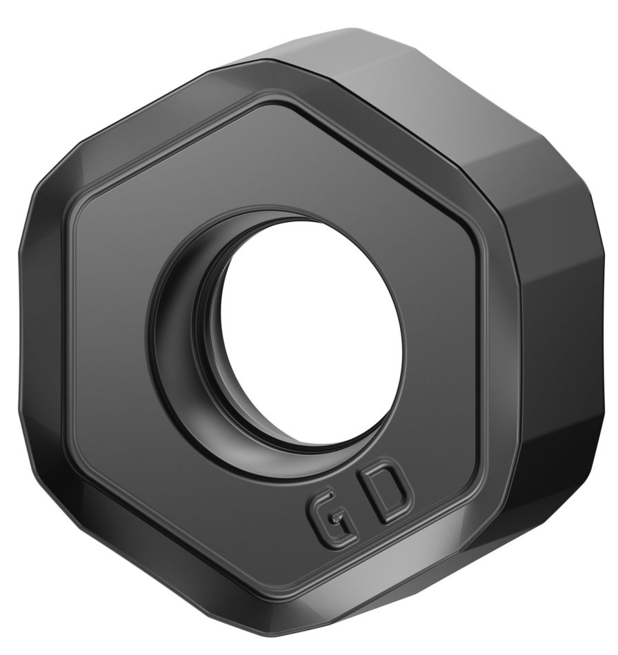

Dodeka™ Mini • Carbide Insert • HNPJ-GD • Medium Machining
Face milling insert with twelve cutting edges
Material Number4119698
ISO Catalog IDHNPJ0604ANSNGDANSI Catalog IDHNPJ43ANSNGD
Dodeka Mini Carbide Insert - HNPJ-GD - Grade KCPM20 - 4119698 - Kennametal.com
$28.05/each
Drawings for 4119698
GradeKCPM20
[D] Insert IC Size12 mm
[D] Insert IC Size0.472 in
[BS] Corner Facet Length 1.452 mm
[BS] Corner Facet Length 0.0572 in
[L10] Insert Cutting Edge Length6.928 mm
[L10] Insert Cutting Edge Length0.2728 in
[Rε] Corner Radius 1 mm
[Rε] Corner Radius 0.039 in
[S] Insert Thickness4.445 mm
[S] Insert Thickness0.175 in
Average Chip Thickness [HM]0.082 mm
Average Chip Thickness [HM]0.0032 in
Cutting Edges per Insert12
KCPM20
KCPM20
Coated carbide grade with CVD multilayer (TiN/MT TiCN/Al2O3) and advanced Beyond™ post-coat treatment. Substrate is a well-balanced combination of wear resistance and toughness. It is primarily for light and general machining of steel and stainless steel roughing of cast irons.
  • Pressed-to-size, for lowest cost per cutting edge
  • Insert for Dodeka Mini 15/45/60 cutters (metric)
  • Insert for Dodeka Mini 75/45/30 cutters (inch)
