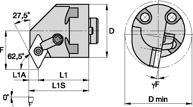

Material Number1095383
ISO Catalog IDH24MDPNR4
ANSI Catalog IDH24MDPNR4
[D] Adapter / Shank / Bore Diameter38.1 mm
[D] Adapter / Shank / Bore Diameter1.5 in
[DM] Minimum Bore Diameter 50.8 mm
[DM] Minimum Bore Diameter 2 in
[F] F Dimension 28.575 mm
[F] F Dimension 1.125 in
[L1] Tool Length 34.671 mm
[L1] Tool Length 1.365 in
[L1A] L1 A Dimension 6.604 mm
[L1A] L1 A Dimension 0.26 in
[L1S] Secondary Tool Length 41.275 mm
[L1S] Secondary Tool Length 1.625 in
[GAAP] Axial Rake Angle0
Gage InsertDN..432
Lock Pin ID Drive Size3/32
Clamp Screw ID Drive Size1/8
