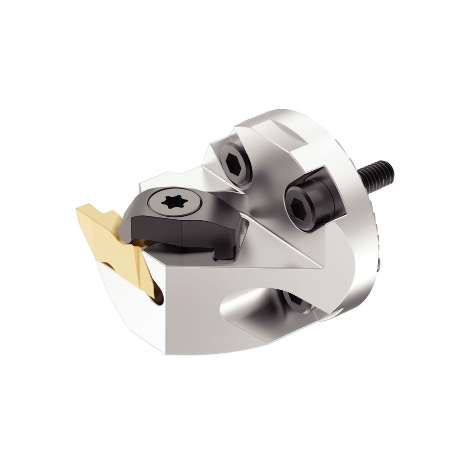

Top Notch™ • Grooving/Threading • NE 90°
Bolt-On Heads Through Coolant • Top Notch™ • NE 90°
Material Number6754895
ISO Catalog IDH5063NER6WANSI Catalog IDH5063NER6W
Top Notch™ H5063NER6W Boring Bar 6754895 - Kennametal
$425.84/each
  • I.D. GroovingI.D. Grooving
  • I.D. Internal ThreadingI.D. Internal Threading
  • BoringBoring
  • ThreadingThreading
Drawings for 6754895
[D] Adapter / Shank / Bore Diameter50 mm
[D] Adapter / Shank / Bore Diameter1.97 in
[DM] Minimum Bore Diameter 63 mm
[DM] Minimum Bore Diameter 2.4803 in
[F] F Dimension 35 mm
[F] F Dimension 1.378 in
[L1] Tool Length 38.638 mm
[L1] Tool Length 1.5212 in
Gage InsertNG_6L
  • BoringBoring
  • Boring with extended overhangs up to 10 x D.
  • No tuning required.
  • Lighter weight bolt on heads.
  • Serrated interface for a secure connection.
  • High pressure compatible. Please refer to the boring bar specifications for maximum admissible pressure.
