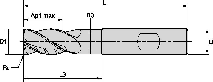

HARVI™ I TE 四刃立铣刀,用于粗加工和精加工,涵盖最广泛的应用和材料

- Versatile solid carbide end mill for steels, stainless steel, cast iron, and high temperature alloys
- HARVI™ I TE solid carbide end mills cover a variety of operations, including dynamic milling, and extreme ramping operations
- HARVI™ I TE solid carbide end mills stand for maximum metal removal, maximum productivity, maximum benefit
- HARVI™ I TE solid carbide end mills feature asymmetrical divided flutes, variable helix, twisted end face, faceted eccentric relief, and chip gashes within the flutes
- Center cutting for plunging and ramping operations

刀具尺寸: 排屑槽数: 4
刀柄— 圆柱 Weldon
刀尖类型: 刀尖半径
