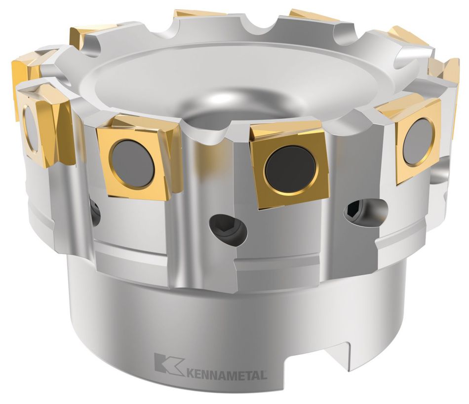

Fix-Perfect™ 90° Cast Iron Series • Shell Mill • Fixed Pockets • Metric
Tangential face milling cutter for cast iron machining.
Material Number1503012
ISO Catalog ID63A06RP90SP12CFPANSI Catalog ID63A06RP90SP12CFP

- Milling cutter for roughing of cast iron and compacted graphite iron (CGI).
- High feed rates through tangentially mounted inserts.
- Pocket design protects non-engaged cutting edges.
- Insert stud clamping mechanism safely manages high RPM's.
