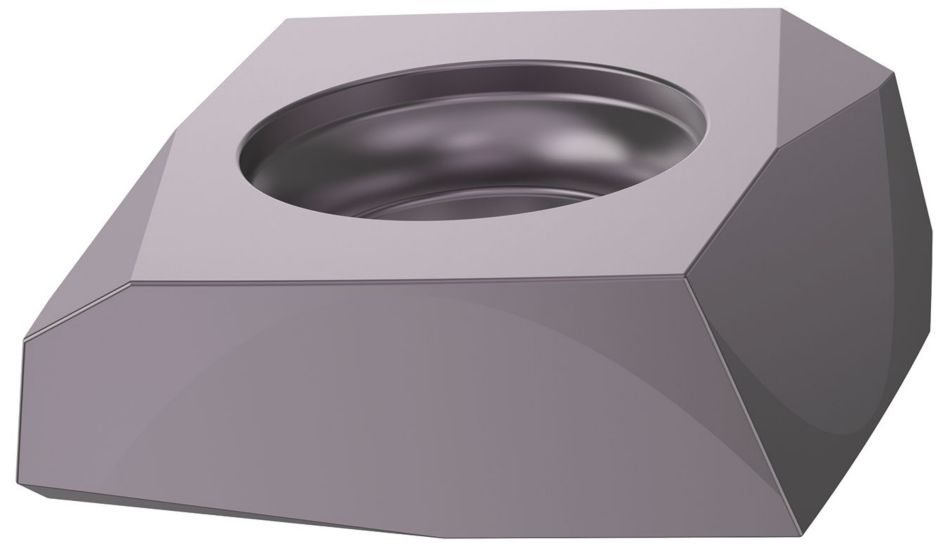

Face milling insert with four cutting edges, precision ground.
Material Number1874250
ISO Catalog IDMDHX1004ZDFRGD4WANSI Catalog IDMDHX1004ZDFRGD4W

GradeKC520M
KC520M
KC520M
Coated carbide grade with TiAlN coating (PVD). KC520M is a carbide grade developed specifically for general machining of ductile cast iron. This grade can be used with or without coolant.
  • High-precision ground insert for superior surface finish and flatness.
  • Milling insert for cast iron and compacted graphite iron (CGI) machining.
  • Sharp wiper cutting edge.
