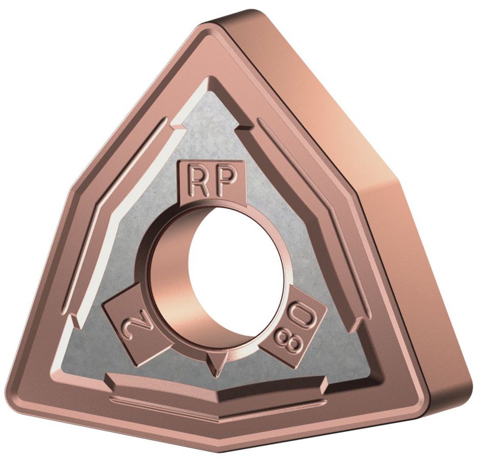

Kenloc™ • WNMG Insert • Negative • RP
ISO Turning Carbide Insert • Roughing Positive Geometry
Material Number5641122
ISO Catalog IDWNMG080408RPANSI Catalog IDWNMG432RP
Kenloc™ WNMG ISO/ANSI Turning Insert 5641122 - Kennametal

KCM15B
KCM15B
Composition: A multilayer MTCVD-TiCN-Al2O3 coated carbide grade.
Application: An excellent finishing to medium machining grade for austenitic stainless steels at higher speeds and covers a broad range of steel applications in the P20-25 range. KCM15 grade in combination with unique geometries have been designed to resist depth-of-cut notching and minimize burr formation. The post-coat treatment reduces coating stresses, improves coating adhesion, minimizes microchipping and edge build-up, and improves workpiece finish.
