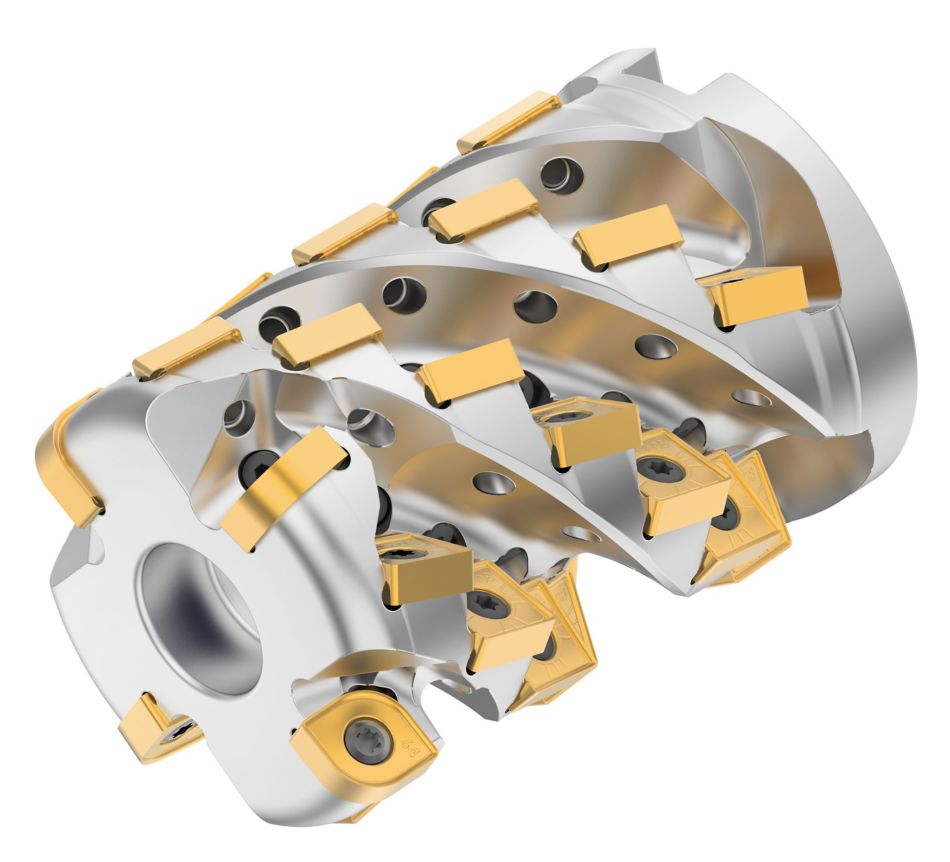

HARVI™ Ultra 8X • Helical Shell Mill • SNHJ12 • For Corner Radius from 4,8-6,4mm • Metric
Shoulder milling cutter for steel, stainless steel, and high-temperature alloys.

Material Number6423305
ISO Catalog IDHU8X080S12S32ZU5AP102Z50R
ANSI Catalog IDHU8X080S12S32ZU5AP102Z50R
[D1] Effective Cutting Diameter80 mm
[D1] Effective Cutting Diameter3.15 in
[D] Adapter / Shank / Bore Diameter1.26 in
[D6] Hub Diameter 77 mm
[D6] Hub Diameter 3.031 in
[L] Overall Length 115 mm
[L] Overall Length 4.528 in
[AP1MAX] 1st Maximum Cutting Depth102.19 mm
[AP1MAX] 1st Maximum Cutting Depth4.023 in
Number of Inserts50
[Z] Number of Flutes5
Weight Kilograms2.46
Max RPM12900
  • Slotting: Shoulder ProfilingSlotting: Shoulder Profiling
  • Slotting: ShoulderSlotting: Shoulder
  • PocketingPocketing
  • Accomodates inserts with corner radii from 4,8-6,4mm (.188" - .250") in the lead row.
  • Designed for aerospace airframe structural component machining, targeting maximum metal removal rates (MRR).
  • Adjustable coolant nozzles support chip evacuation and control heat in the cutting zone.
  • Large helix ensures hassle-free chip evacuation event at highest metal removal rates (MRR).
