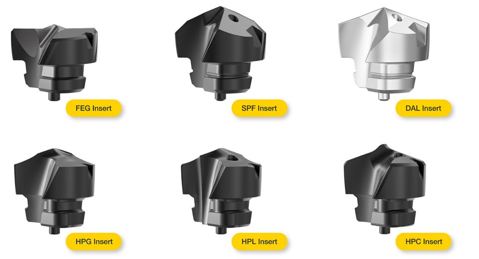

KenTIP FS Modular drill FEG insert, SPF insert, DAL insert, HPG insert, HPL insert, and HPC insert

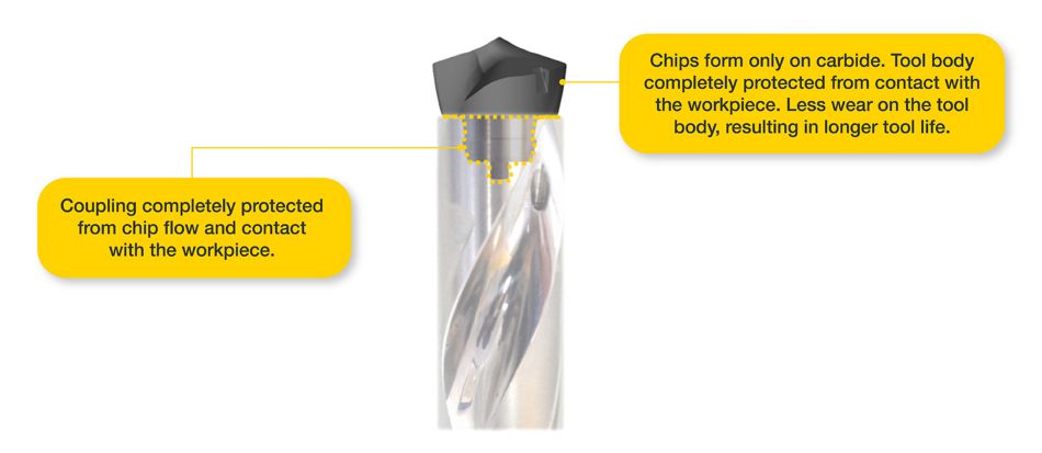

To make it happen we had to rethink the design of the carbide insert and the clamping mechanism. The result is a full solid carbide front, which helps in two ways. It ensures that chip formation happens only on carbide, so the drill body does not have to battle abrasive wear. Secondly, it protects the interface and helps to extend the tool life of the drill body.
The KenTIP FS has wider and deeper flutes than other modular drills. The ultra-high polished chip flutes enable reliable chip evacuation with less friction, resulting in less holder wash-out and longer tool life.
KenTIP FS modular drill full solid carbide front diagram
Full solid carbide front.

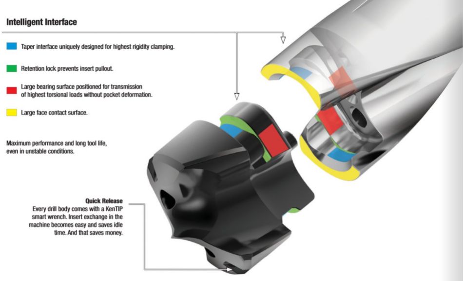

Q: How does the tip hold on to the body, and how strong is that connection?
This is the most interesting part! With modular drilling, you're only as strong as your interface - a point where an insert and a body are connected. We had to make that connection as strong as possible, so it could handle high forces and reach the increased feed rates. To design the best solution, we gathered a global team of engineers, including metal cutting specialists from the US, Germany, and India. Together, we created an innovative interface that reduces the stress. Less stress in "the pocket seat" means the KenTIP FS can handle more forces. And that allows you to push the drill harder for higher feed rates.
KenTIP FS modular drill intelligent interface diagram
The secrets of the intelligent interface

Achieving efficient cooling and lubrication in the cutting zone, is one of the main challenges in drilling. Experience shows that different approaches are required to get best results in different workpiece materials. So, we needed the coolant flow to change as the inserts for different materials change. While most of the modular drill systems on the market have just two coolant holes, the KenTIP FS drill body has four coolant holes.
Adhesion and flank wear are a big concern in stainless steels and cast irons. Inserts with HPL and HPC point geometry have coolant channels to provide better lubrication in this area to overcome the issue. In steels though, it’s better to concentrate coolant to the rake face and take the heat from the contact zone between chip and rake face. To raise insert tool life and improve chip breakage in steels, the HPG point geometry comes without coolant channels.

We made the process of changing the inserts as smooth as possible. Just clean the pocket with an air blast, put the insert into the pocket with your fingers, and tighten it with the wrench you receive with each KenTIP FS. You can do all that without even taking the tool's body out of your machine. Timesaving, isn't it?
0:00 / 0:00
Insert mounting - a piece of cake
