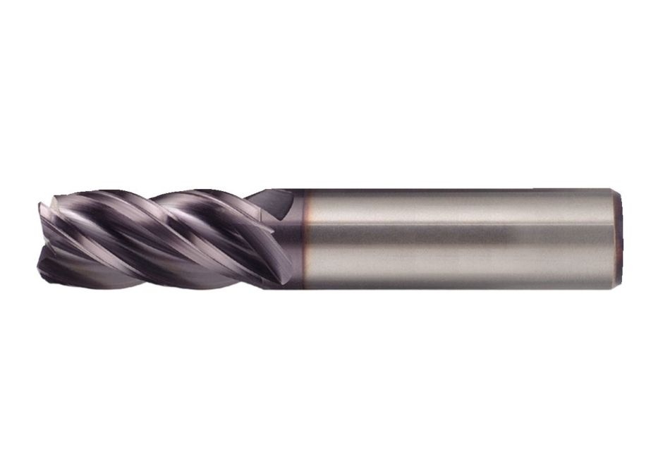

HARVI™ I • Square End • 4 Flutes • Weldon® Shank • Inch
HARVI™ I Solid Carbide End Mill for Roughing and Finishing of High-Temperature Alloys
Material Number3331467
ISO Catalog IDHPHVT500S4125ANSI Catalog IDHPHVT500S4125
HARVI™ I - Square End - 4 Flutes - Weldon® Shank - Inch 3331467 - Kennametal
$222.11/each
  • Tool Dimensions: Flute Configuration: 4Tool Dimensions: Flute Configuration: 4
Drawings for 3331467
GradeKC643M
Adapter Style Machine SideWeldon
[D1] Effective Cutting Diameter12.7 mm
[D1] Effective Cutting Diameter0.5 in
[D] Adapter / Shank / Bore Diameter12.7 mm
[D] Adapter / Shank / Bore Diameter0.5 in
[AP1MAX] 1st Maximum Cutting Depth31.75 mm
[AP1MAX] 1st Maximum Cutting Depth1.25 in
[L3] Usable Length31.75 mm
[L3] Usable Length1.25 in
[L] Overall Length 76.2 mm
[L] Overall Length 3 in
[Z] Number of Flutes4
KC643M
KC643M
Coated fine-grain grade with PVD multilayer (AlTiN). KC643M™ is a very thin and hard PVD coating particularly suited for cutting steel, cast iron, stainless steel (wet), and titanium (wet). This grade can be used for materials with hardness up to 52 HRC.
  • Versatile solid carbide end mill for steels, and high temperature alloys.
  • HARVI™ I solid carbide end mills cover a variety of operations, including dynamic milling.
  • HARVI™ I solid carbide end mills features unequal flute spacing for chatter-free machining.
