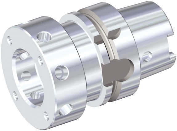

SIF-HSK63 Form A
SIF™ Steerable Toolholder
Material Number3738508
ISO Catalog IDHSK63ASIF70066MANSI Catalog IDHSK63ASIF70066M
Hole Finishing SIF Steerable Toolholder
$834.76/each
Drawings for 3738508
[CSMS] System Size Machine SideHSK63A
[CSWS] System Size Workpiece SideSIF70
[D2] Body Diameter 1 Workpiece Side 70 mm
[D2] Body Diameter 1 Workpiece Side 2.756 in
[D1] Adapter / Shank / Bore Diameter38 mm
[D1] Adapter / Shank / Bore Diameter1.496 in
[L1] Gage Length66 mm
[L1] Gage Length2.598 in
Weight Kilograms1.44
Weight Pounds3.18
  • Through-the-toolholder coolant capability.
  • Suitable for SIF adapters.
