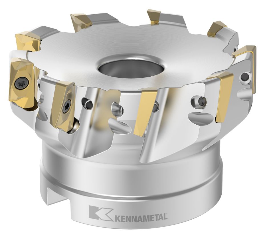

Mill 1-14™ Shell Mills • Metric
Indexable Shell Mills
Material Number100004247
- Aggressive ramping rates.
- Generates superior surface finish.
- Mill 90° walls.
- High RPM capabilities.
Face Milling
Helical Milling
Ramping: Blank
Slotting: Square End
Milling - Through Coolant
Milling - Side and Face
Pocketing
