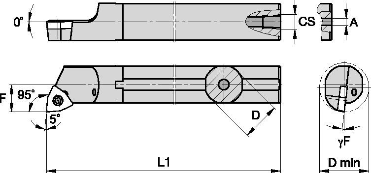

Drawings for 1098064
Material Number1098064
ISO Catalog IDA16RSWLCR06
ANSI Catalog IDA16RSWLCR06
[D] Adapter / Shank / Bore Diameter16 mm
[D] Adapter / Shank / Bore Diameter0.63 in
[DM] Minimum Bore Diameter 20 mm
[DM] Minimum Bore Diameter 0.787 in
[F] F Dimension 11 mm
[F] F Dimension 0.433 in
[L1] Tool Length 200 mm
[L1] Tool Length 7.874 in
[CS] Coolant Supply Size1/8-27 NPT
[A] Coolant Hole Diameter 3.96 mm
[A] Coolant Hole Dia 0.156 in
Gage InsertWC..06T308
Insert Screw ID Drive SizeT15
