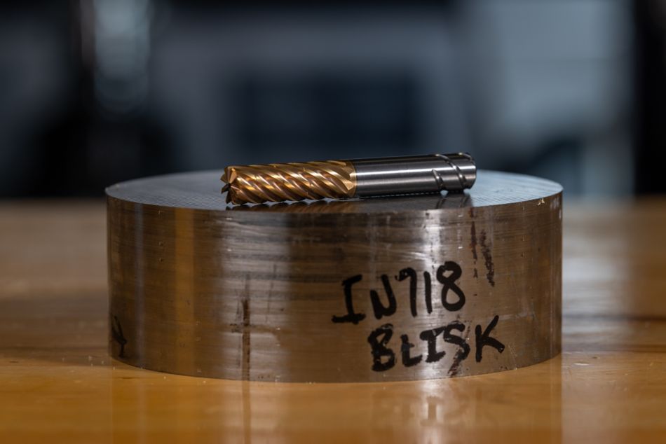

Choose the Right Tool: Selecting the right tool for the job is always important. Tools should be able to handle the cutting forces and provide the necessary chip evacuation for the material being machined. For example, the Kennametal Mill 1™ shoulder mill is an example of a tool designed for ramping and milling within holes and pockets. It provides greater clearance beneath the insert. Its innovative insert and cutter body designs offer improved ramping capabilities. Another example is the HARVI™ I TE which is fantastic for aggressive ramping at reduced feed rates. These mills are applicable for a variety of operations, including dynamic milling, and extreme ramping operations.

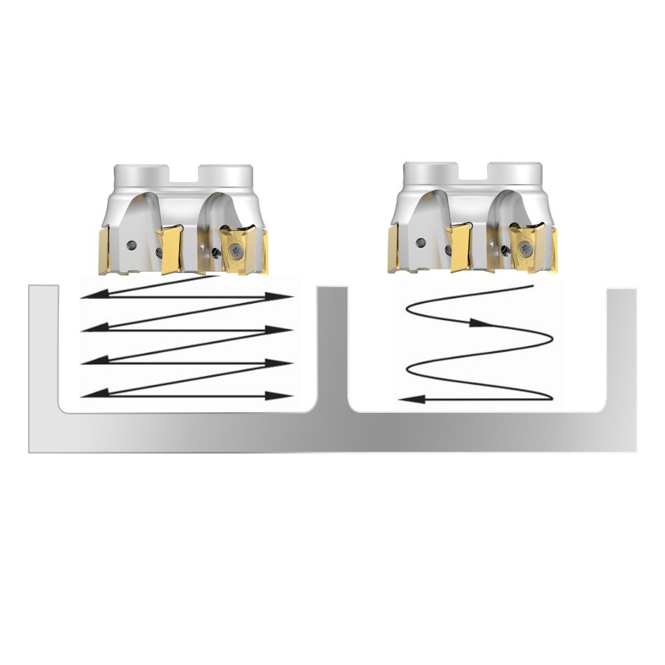

Helical Interpolation and Linear Ramping
As we discuss ramping in milling, we should also mention the differences between helical interpolation and linear ramping. Each method has distinct differences that make them suitable for different milling applications. Depending on your application, each technique can effectively help you achieve your goals. Here are some key differences:
Helical interpolation or circular ramping is used to machine tighter pockets of the workpiece. The cutter moves in a continuous spiral. It distributes the cutting forces across the X or Y axis and the Z axis. It allows for precise and efficient machining to create holes, threads, and grooves.
Linear ramping also involves moving the cutting tool across the X or Y axis and the Z axis.
In helical ramping, the angle of entry determines the direction of the cut. The most common entry method is climb milling (thick to thin or down milling.) With this tool path the cutter revolves in the same direction as the table feed.
