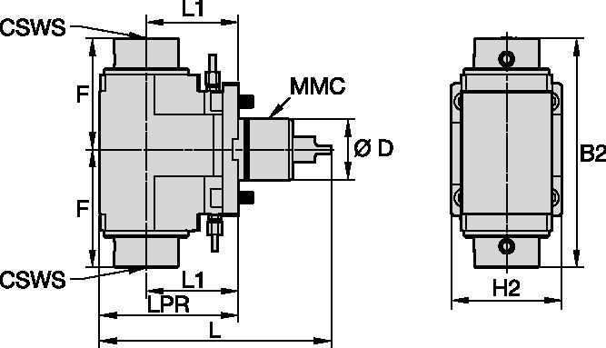

Drawings for 6201274
Material Number6201274
ISO Catalog IDTACU002KM50DR60648459
ANSI Catalog IDTACU002KM50DR60648459
MAR_ASTERISK*
[CSWS] System Size Workpiece SideKM50
Machine Mount Code002
[B2] Overall Width 224 mm
[B2] Overall Width 8.8189 in
[D] Adapter / Shank / Bore Diameter59.9 mm
[D] Adapter / Shank / Bore Diameter2.3583 in
[F] F Dimension 109 mm
[F] F Dimension 4.2913 in
[FS] Secondary F Dimension 115 mm
[FS] Secondary F Dimension 4.5276 in
[H2] Overall Height 108 mm
[H2] Overall Height 4.252 in
[L] Overall Length 227 mm
[L] Overall Length 8.937 in
[L1] Gage Length90 mm
[L1] Gage Length3.5433 in
[LPR] Protruding Length 136 mm
[LPR] Protruding Length 5.3543 in
Torque Machine Spindle Nm100
Coolant Pressure Bar100
Coolant Pressure PSI1500
Coolant DeliveryE
[CS1] Coolant Supply Exit SizeG 1/8
Max RPM6000
Weight Kilograms15.49
Torque Catalog Newton Meters27-34
Torque Catalog Foot Pounds20-25
