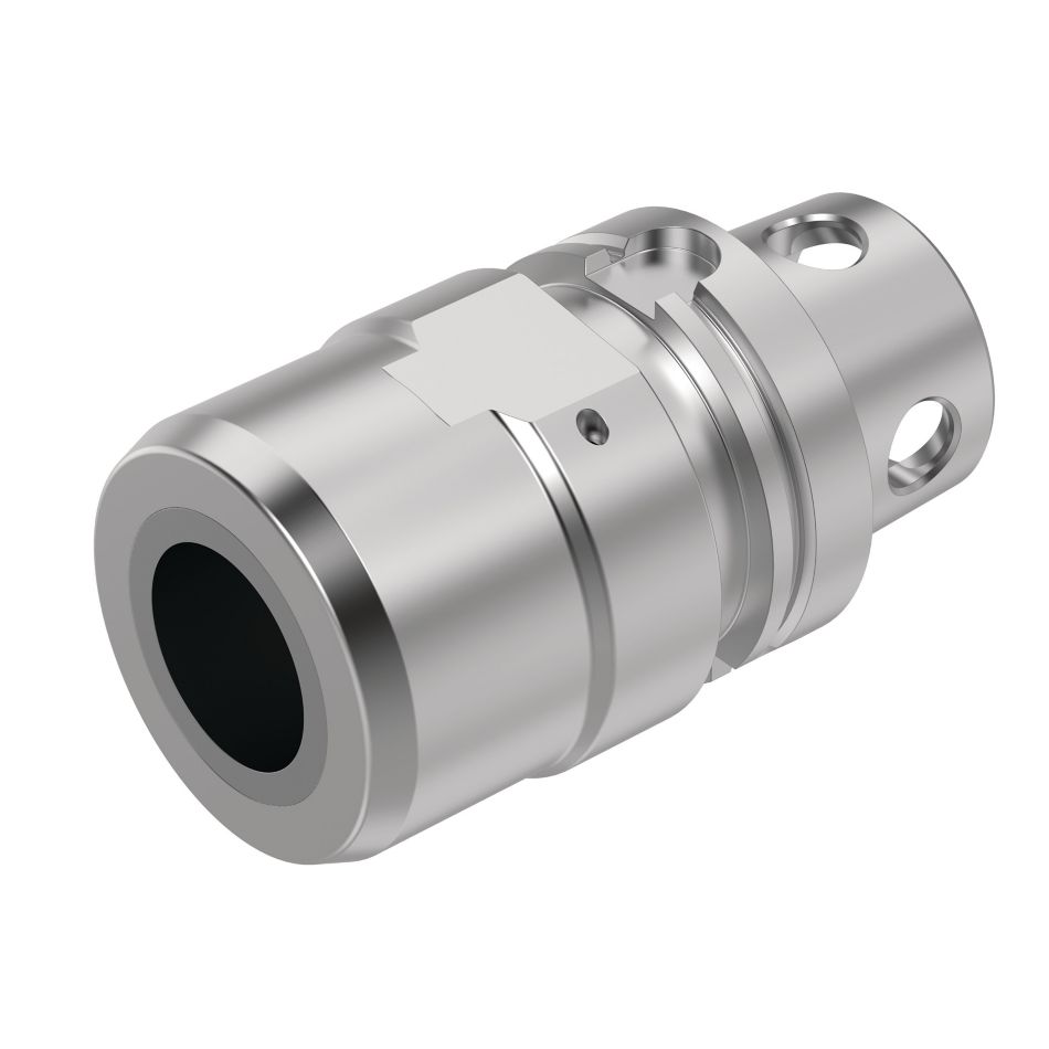

HC HT KM4X Inch • KM4X100
HydroForce™ Hydraulic Toolholders High Torque (HT)
Material Number6381973
ISO Catalog IDKM4X100HCTHT200531ANSI Catalog IDKM4X100HCTHT200531
Hydraulic Chucks HydroForce™ High Torque Line • KM4X™
$1,236.96/each
  • Accuracy - 3μm or LessAccuracy - 3μm or Less
  • Accuracy - 6μm or LessAccuracy - 6μm or Less
  • Balance - G 2.5@25,000 min-1Balance - G 2.5@25,000 min-1
  • Shank: KM4X™Shank: KM4X™
Drawings for 6381973
[D1] Adapter / Shank / Bore Diameter50.8 mm
[D1] Adapter / Shank / Bore Diameter2 in
[D2] Body Diameter 1 Workpiece Side 100 mm
[D2] Body Diameter 1 Workpiece Side 3.937 in
[D21] Body Diameter 2 Workpiece Side105 mm
[D21] Body Diameter 2 Workpiece Side4.134 in
[L1] Gage Length135 mm
[L1] Gage Length5.315 in
[L2] Usable Length 56 mm
[L2] Usable Length 2.205 in
[L9] Clamping Length 71 mm
[L9] Clamping Hole Length 2.795 in
[V] Adjustment Range 10 mm
[V] Adjustment Range 0.398 in
Actuation Screw ID Drive Size10 mm
Stop Screw ID Drive Size10 mm
Weight Pounds15.87
