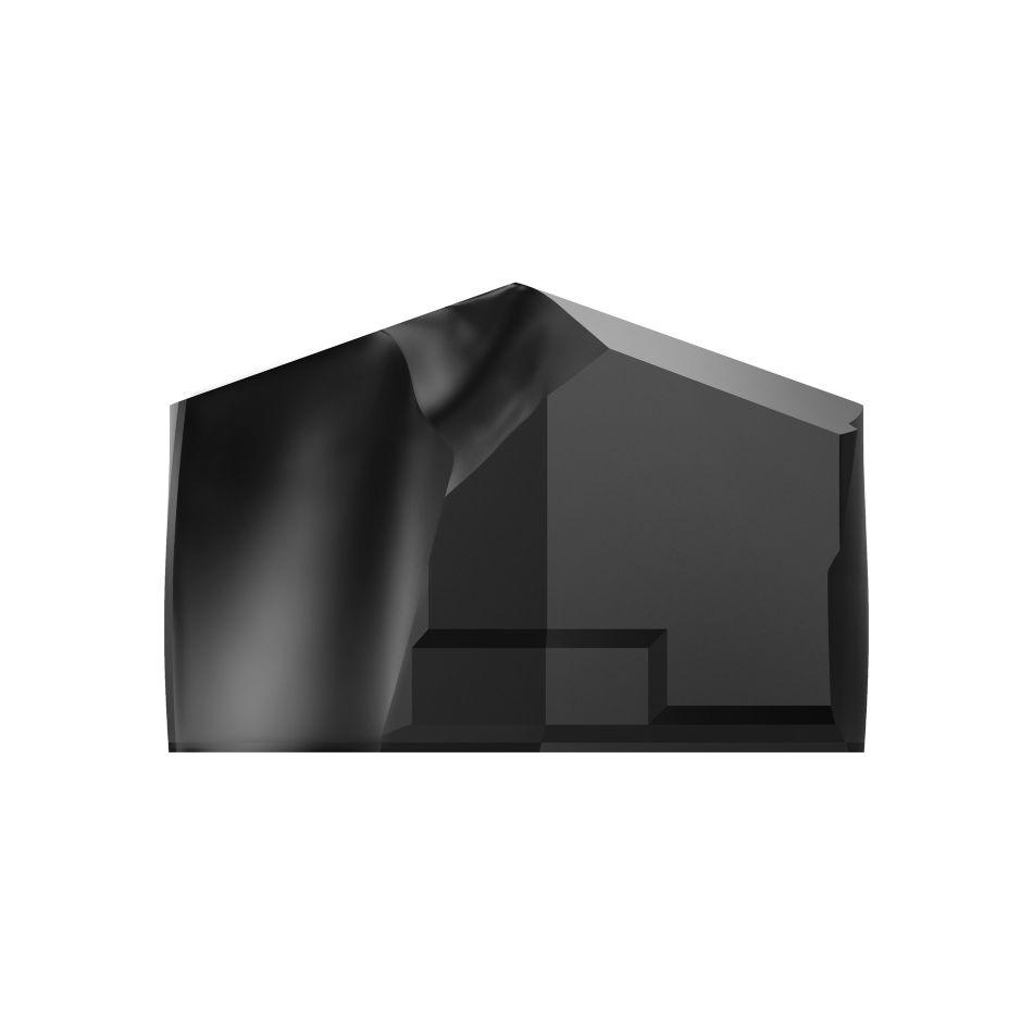

KSEM™ • Center Insert • SPL Geometry
Modular Drilling • Carbide Insert for KSEM™
Material Number5964167
ISO Catalog IDKSEM2400SPLMANSI Catalog IDKSEM2400SPLM
- P Steel
- M Stainless Steel
- N Non-Ferrous
- S High-Temp Alloys
Drilling
Drilling: Inclined Exit
Drilling: Stacked Plates
Tool Dimensions: 2flute/4margin/coolant
Material Number | 5964167 |
ISO Catalog ID | KSEM2400SPLM |
ANSI Catalog ID | KSEM2400SPLM |
Grade | KCMS35 |
[D1] Drill Diameter | 24 mm |
[D1] Drill Diameter | .9449 in |
[L5] Drill Point Length | 4.07 mm |
[L5] Drill Point Length | .16 in |
[SSC] Insert Seat Size | 4 |
- Steel
- Stainless Steel
- Non-Ferrous
- High-Temp Alloys
Drilling
- SPL geometry for modular drilling with low cutting forces in high temperature alloys, and non-ferrous materials.
- Four-facet geometry with four margin lands for perfect centering and hole straightness.
