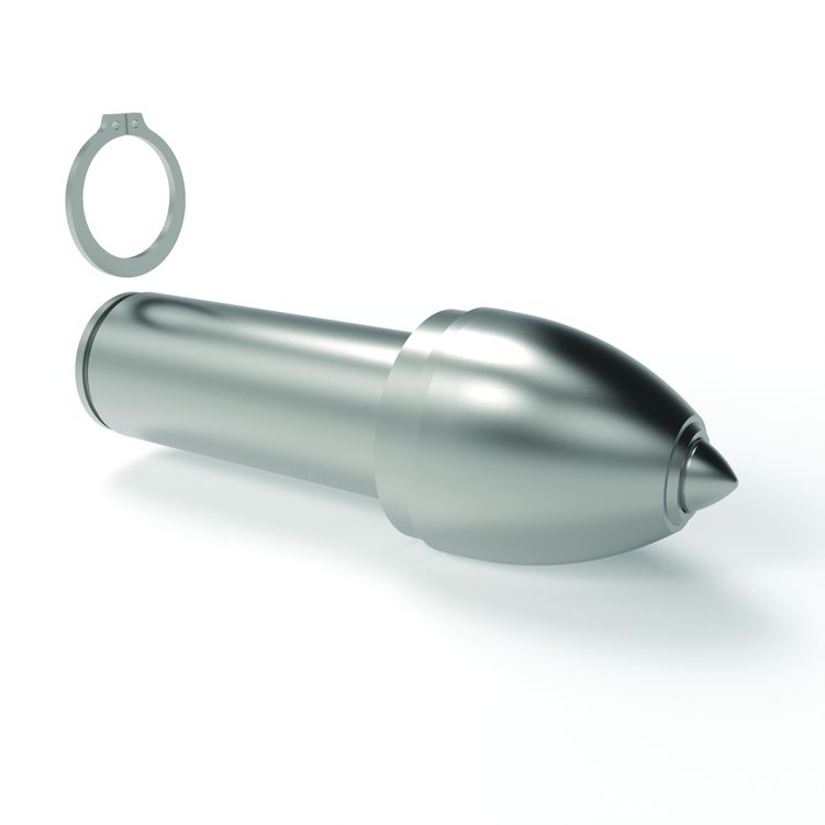

How to Select a Crusher Conical Bit
Selecting the right crusher depends on several factors, including the type of material being crushed, the desired particle size, and the capacity requirements. Here are some steps to help you choose the right crusher tooling:
Shank Size: The shank size refers to the diameter of the shank that connects the crusher to the drilling machine. Make sure to select a crusher with a shank size that matches your machine.
Gauge Length: The gage length is the distance from the end of the crusher to the cutting point. The gage length should be selected based on the thickness of the material being crushed. For thinner materials, a shorter gage length is preferred.
Identify Cutting Condition: The cutting condition refers to the type of material being crushed and the level of difficulty of the job. Light-cutting conditions involve softer materials and require less force, while heavy-cutting conditions involve harder materials and require more force.
Insert Type: Choose the insert type based on the cutting condition. A plug or bullet nose insert is suitable for light to medium cutting conditions, while a narrow bottom insert is better for heavy cutting conditions.
Body Style: The body style of the crusher affects its life and penetrability. A heavy or standard body style is recommended for extended life, while a slim or finned body style is better for improved penetration.

A T- Shank Crusher Bit
