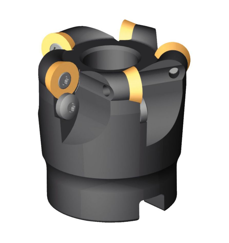

| Material Number | 1888200 |
| ISO Catalog ID | 80A07RSMORD12 |
| ANSI Catalog ID | 80A07RSMORD12 |
| [D1MAX] Maximum Cutting Diameter | 80 mm |
| [D1MAX] Maximum Cutting Diameter | 3.15 in |
| [D1] Effective Cutting Diameter | 68 mm |
| [D1] Effective Cutting Diameter | 2.6772 in |
| [D] Adapter / Shank / Bore Diameter | 27 mm |
| [D] Adapter / Shank / Bore Diameter | 1.063 in |
| [D6] Hub Diameter | 50 mm |
| [D6] Hub Diameter | 1.969 in |
| [L] Overall Length | 50 mm |
| [L] Overall Length | 1.969 in |
| [AP1MAX] 1st Maximum Cutting Depth | 6 mm |
| [AP1MAX] 1st Maximum Cutting Depth | 0.236 in |
| Number of Inserts | 7 |
| Maximum Ramping Angle | 3.5 |
| Weight Kilograms | 0.92 |
| Max RPM | 4900 |
| Gage Insert | RD.X12T3MO. |

- Engineered for maximum performance.
- High runout accuracy.
- Suitable for die and mould manufacturing.
