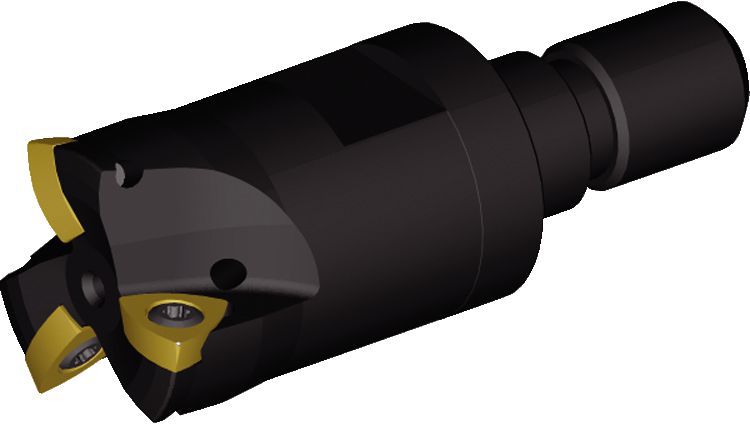

KenFeed™ Mini • End Mill • Screw-On • Metric
Copy milling cutter for multiple materials.
Material Number3651443
ISO Catalog ID20Y03R030M10SWP03
ANSI Catalog ID20Y03R030M10SWP03
[D1MAX] Maximum Cutting Diameter20 mm
[D1MAX] Maximum Cutting Diameter0.787 in
[D1] Effective Cutting Diameter14.24 mm
[D1] Effective Cutting Diameter0.561 in
[D] Adapter / Shank / Bore Diameter18 mm
[D] Adapter / Shank / Bore Diameter0.7087 in
[WF] Width of Flat 15 mm
[WF] Width of Flat 0.587 in
[G3X] Connection Thread Size ExternalM10
[L2] Head Length 30 mm
[L2] Head Length 1.181 in
[AP1MAX] 1st Maximum Cutting Depth0.84 mm
[AP1MAX] 1st Maximum Cutting Depth0.033 in
Number of Inserts3
Maximum Ramping Angle7
Weight Kilograms0.06
Max RPM15900
Gage InsertWP..0302.
  • 3D Profiling3D Profiling
  • PocketingPocketing
  • Engineered to use with small machines and/or components using high-feed milling strategies.
  • Fine-pitch cutters boost productivity; able to run up to 1,5mm fz.
  • Pocketing, ramping, and helical interpolations.
  • First choice above 3 x D applications.
