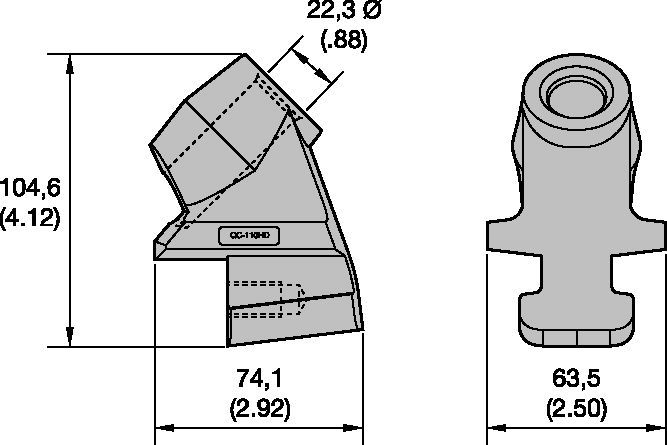

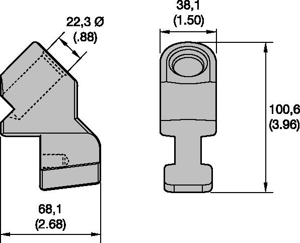

    QC110 87 Holder
    1012293
    QC110 87 HOLDER
    QC110 87 HOLDER
    QC187HD
    1588922
    QC187HD
    QC187HD
