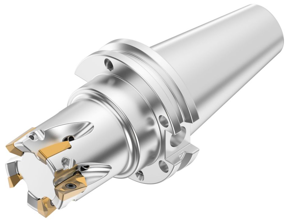

Mill 1-14™ • End Mill • Steep Taper CV40 • Inch
Material Number2624246
ISO Catalog IDM1D100E1403CV40L300ANSI Catalog IDM1D100E1403CV40L300

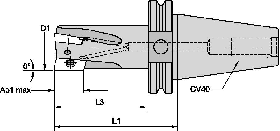

Shank - SK CAT(CV) ANSI B5.50
Material Number | 2624246 |
ISO Catalog ID | M1D100E1403CV40L300 |
ANSI Catalog ID | M1D100E1403CV40L300 |
[D1] Effective Cutting Diameter | 25.4 mm |
[D1] Effective Cutting Diameter | 1 in |
[L1] Gage Length | 76.2 mm |
[L1] Gage Length | 3 in |
[L3] Usable Length | 38.1 mm |
[L3] Usable Length | 1.5 in |
[AP1MAX] 1st Maximum Cutting Depth | 14.5 mm |
[AP1MAX] 1st Maximum Cutting Depth | 0.57 in |
[CSMS] System Size Machine Side | CV40 |
Number of Inserts | 3 |
Maximum Ramping Angle | 10.2 |
Weight Pounds | 2.4 |

- Internal coolant supply.
- For ramping, slotting, plunging, facing, and true 90° walls.
