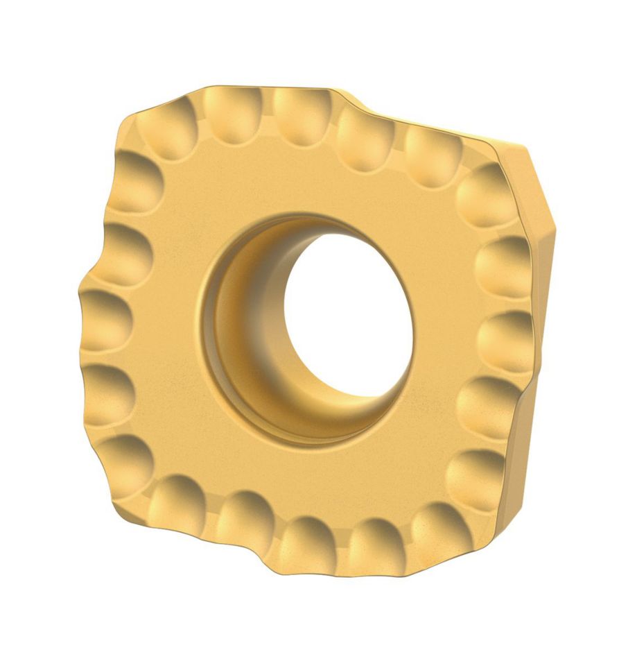

Drill Fix PRO™ • Carbide Insert • Inboard • LC Geometry
Drilling insert for Long Chipping Materials
Material Number7034242
ISO Catalog IDDFPR100305LCIANSI Catalog IDDFPR100305LCI
Drill Fix PRO™ - Carbide Insert - Inboard - LC Geometry 7034242 - Kennametal

Drawings for 7034242
GradeKC7140
[D1] Insert Hole Size 3.45 mm
[D1] Insert Hole Size 0.136 in
[D] Insert IC Size9.9 mm
[D] Insert IC Size0.39 in
[RR] Corner Radius0.5 mm
[RR] Corner Radius0.02 in
[W] Cutting Width 8.09 mm
[W] Cutting Width 0.318 in
[S] Insert Thickness3 mm
[S] Insert Thickness0.118 in

KC7140
KC7140
Composition: PVD TiCN/TiN coated medium-grain carbide with high toughness.
Application: Best suited for machining of steel and stainless steel. This exceptionally tough grade is perfectly suited for metastable machining conditions offering excellent tool life.
  • Four true cutting edges for lowest cost per part.
  • Inboard Insert with unique nose-profile for best positioning accuracy.
