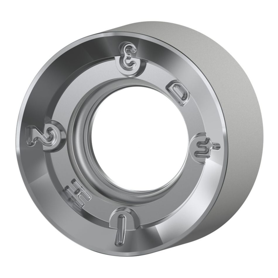

Rodeka™ IC10 • Carbide Insert • RNPJ-HD • Heavy Machining
Copy milling insert with eight cutting edges.
Material Number100003701
- Pressed-to-size, for lowest cost per cutting edge.
- Double-sided design with anti-rotation feature allowing for eight precise indexes.
